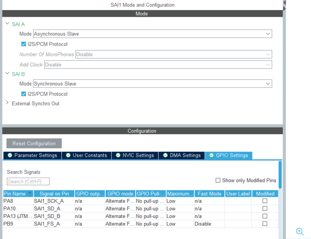

I would like to use the SAI as full duplex slave mode with I2S/PCM protocol.
I'm not sure about the configuration and which pins are TX and RX when using Cube.

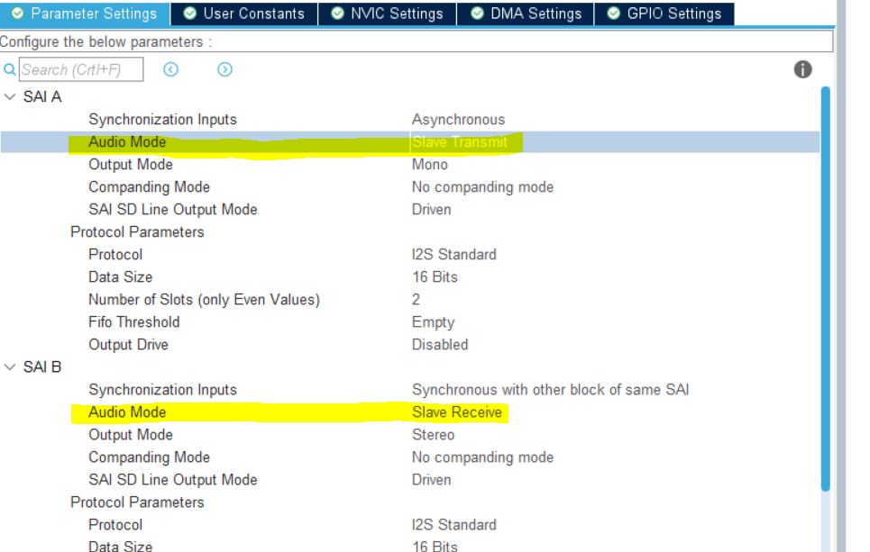

In the parameter I can set the audio to transmit or receive.
In this case SAI_SD_A will be transmit and SAI_SD_B receive?

Hello @NKara.3
Yes, your setup looks correct to me.
