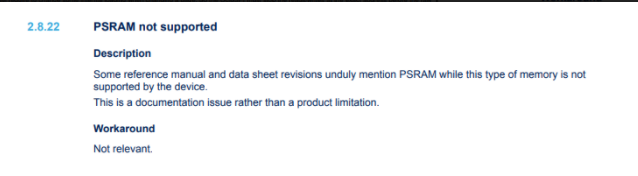

I work with a development team that is developing a product that has a STM32L4S9 MCU and a IS66WVH8M8ALL-100 HyperBus PSRAM.

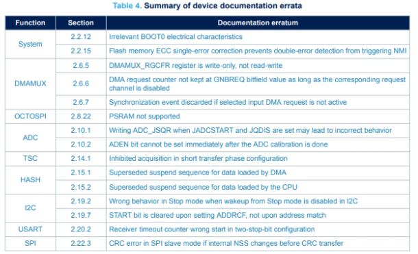

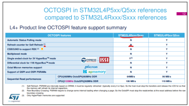

Recently, we found in the STM32L4 Errata that actually this MCU does not support PSRAM. We noticed that the self-refresh was not occuring and data was being lost/corrupted.
We tried changing the OctoSPI configuration, but any attempt did not work.

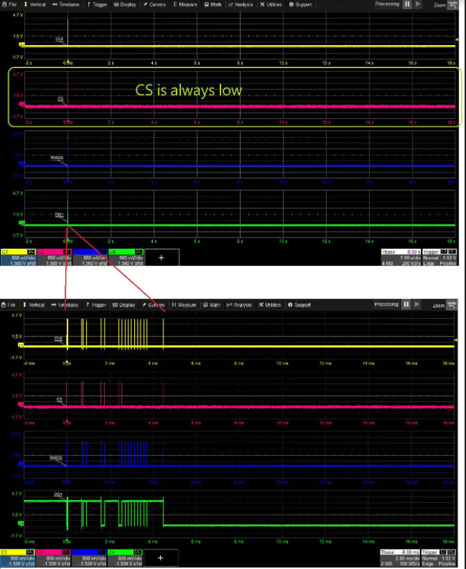

We measured nCS pin, and in fact it is not released in time (4us) to allow the refresh to occur.
0693W00000FCV6sQAH.pngIn our project we use this memory configured as memory mapped, so we can extend the internal memory . The RAM is used to save various user data, framebuffers and more.

I confirm ST doesn't support OPI configuration on this specific version of MCU. following version are supporting IoT RAM (QSPI or OPI PSRAM). One alternative option could be to use ADMUX PSRAM on FMC bus.
fyi, we still have few customers who manage to run our memory for frame buffering (64Mb IoT RAM APS6408L-OBM for example). Key point is you need to avoid odd address write issue. In their use case, since the pixel was 2 bytes, the DMA2D should be 2 bytes aligned, so they had no odd address access.
