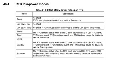

can we wakeup from stop mode from RTC internal alarm
According to the RM0432,  the RTC alarm,RTC tamper event, RTC timestamp event, and RTC Wakeup cause the device to exit the Stop mode.
Best Regards.
