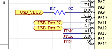

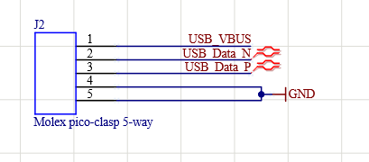

No, we didn't. The USB port (the host PC) provides our board with 5V over a 4.7K resistor in series into pin PA9 (I believe). The power to the board is generated independently. PA9 is read in the background at a frequency of 50 Hz or so, and that starts or stops the USB peripheral accordingly.Cheers,
Alberto

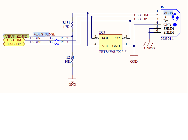

Jtron.11
Senior
I believe if you have the pull low in the USB_VBUS it will help to prevent those glitches, in my case VBUS_SENSE is the same as your USB_ VBUS
