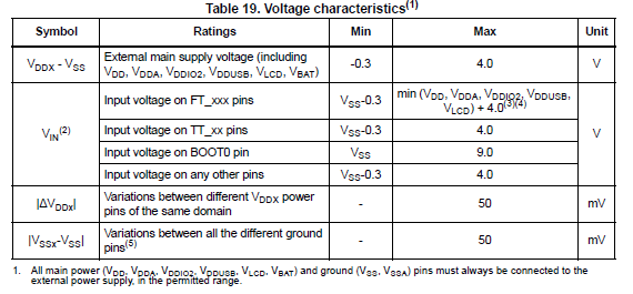

Unfortunately I could not find a maximal input voltage for the ADC in the datasheet. There is a limit for V_AIN, but it is described as ''Conversion voltage range'', see following picture from the datasheet. That the conversion voltage range spans from 0 to VREF+ is obvious but still leaves the question for maximum ADC input voltage.
I also would not expect harm but I hoped to get some definite answer on it.
Do you by chance know if an input-voltage-limit is defined for another ST-processor's ADC? Maybe that's a point to start from as I would expect ST to use similar ADC circuitries in different processors.

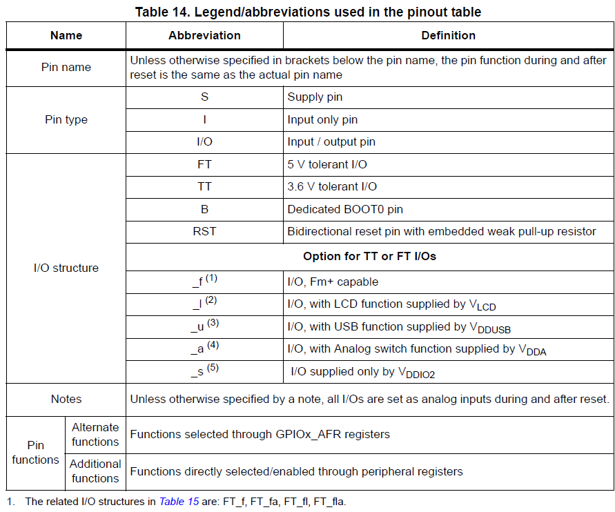

From the STM34L476 datasheet chapter 6.2 Absolute maximum ratings below:
All STM32s have GPIO FT and FF type. This corresponds to the maximum and minimum guaranteed values.
  • FT stands for 5 Volt Tolerant GPIO.
  • FF stands for 3.6V Tolerant GPIO.
Generally Analog IO are FF_a or FT_a and Non-Analog IO are FT, I suggest you consult the datasheet of your device (chapter 4 )
In your case, I think there is no risk of destruction for the analog input and the ADC as long as your signal is less than 3.6V.
On the other hand if your VRef + is the internal reference 2.5V you will not be able to convert the variations of the input signal from 2.5V to 3.6V, there will be saturation of the conversion result.
Change VRef to 3.3 (VDDA) or make a conditioning of your input signal by scaling to meet the full scale of your ADC.
Posted on April 27, 2017 at 10:15
I interpret the parameter name 'Conversion voltage range' and the specified max. values (sect. 6.2, absolute maximum ratings) as definitive answer.
The L devices seem to be reworked for low power, not sure about the protective circuitry. The datasheet for the L device you mention specifies 4.0 V for those analog inputs (TT_xx).
The limits used to be (Vdda + 0.3V) for pins connected to analog peripherals, like ADC inputs. Specifically checked with the F40x.
The term 'Conversion voltage range' means the voltage range that is converted to a proper binary representation.
'Not being converted properly' not automatically implies physical damage to the ADC, but it is probably an issue for your application.
