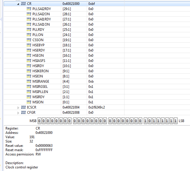

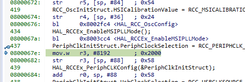

Not stuck the LED in yet and this was QUICK by an unproficient user (me)
Breakpoint inserted HERE just after it gets set in line 4340690X00000606gcQAA.png
Code

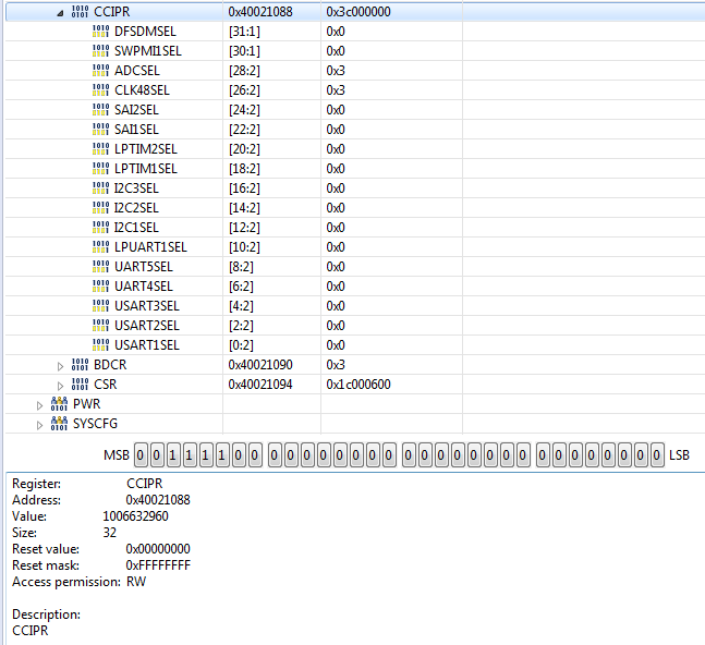

RCC_CR Register
Thats the important one. I'll have to play more to get ''ALL'' of them on here.
Those other 2 bits floating around on the left.... =    RCC_CCIPR.CLK48SEL   - No Wrong register I suppose..
BUT THEY ARE IN THE RIGHT BIT SPOTS !    I'll look.

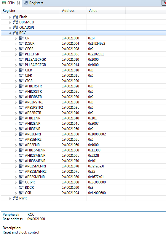

In the debugger, read out and post the content of all RCC registers.
Meetings? Who cares about meetings? I would never work for people who prefer meetings to solutions (yeah but that's me, maybe that's why I still don't have those fancy leather trousers and a pair of colts ;) )
shingadaddy
Senior
Posted on April 01, 2017 at 01:07
Better?

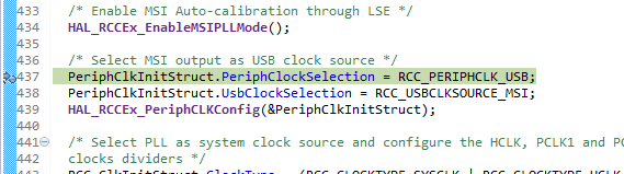

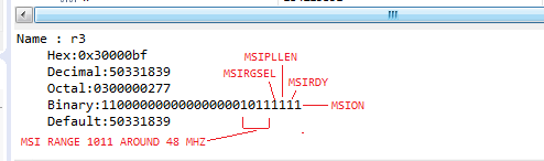

As it turns out, the MSI has is OWN PLL MODE as you probably already know. And to use MSI trimmed with LSE clock
for USB you have to set the clock source for USB to MSI DIRECT.   NOT thorough one of the many OTHER PLL's. So you simply output MSI on MCO.   And my 3 duds MSI's are as follows
PCB #106:  60.69MHz
PCB #107:  58.45Mhz
PCB #109:  54.14Mhz
Yeah. I just sent production a binary that will output LSE now... We'll see what THAT turns up but on the Nucloe where I've already done this little exercise, my scope says 32.769Khz.   And Put back immediately the OTHER way my MSI is 57Mhz.  (It's still *warm* I guess)
shingadaddy
Senior
Posted on April 05, 2017 at 18:21
And running via debugger, I can pause it randomly and the RCC CR and CCIPR are correct. As shown above but the CCIPR has the upper 2 bit that are 1's are now 0's since I'm back to the raw demo code. (No AtoD's)

I looked quickly and only see reference to ICSCR in a GET VALUE
void
HAL_RCC_GetOscConfig(
RCC_OscInitTypeDef
*RCC_OscInitStruct)
RCC_OscInitStruct->
MSICalibrationValue
uint32_t
)((RCC->
ICSCR
& RCC_ICSCR_MSITRIM) >> POSITION_VAL(RCC_ICSCR_MSITRIM));
RCC_OscInitStruct->
MSIClockRange
uint32_t
)((RCC->
CR
& RCC_CR_MSIRANGE) );
I suspect the MAGIC of LSE autotrim might fiddle these maybe?
shingadaddy
Senior
Posted on April 05, 2017 at 18:54
Now here's a headspinner..       The LSE can take as much as 2 seconds to START?
Wonder if the demo code waits that long, for it to be STARTED?
