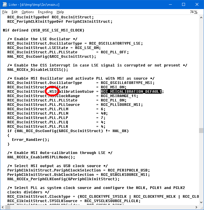

I've been working with USB on my Nucleo board(S)  for some time now. Been comfortably successful at getting a few operational interfaces working with it. Including DFU. STM32L476. So time to make our own PCBS! We knocked out an order for 10 . Production needing 7 and having a few SPARES to help wear off the new. Ran into a little problem and I turned in an online help request. Waited all day and thought maybe someone there might notice I marked it Critical. Not sure of the turnaround time but everybody's critical  might be a little different. Hope I hear and in the mean time here's where I got too.
We have 10 Brand new (Identical) PCB's with STM32L476VG's on them.
They use the direct connected USB for communication. (PA11/PA12)
They are *all* loaded with the same binary, VIA DFU.
DFU works. Dependably.
The binary is the STM32CubleL4 HAL DEMO from EVAL board, with IO EXPANDER commented out. This runs the LEDS on EVAL and is the only thing needed to be removed for this to work. I figure it works good as a TEST LOAD.
Operationally :
  7 Enumerate/seem to work.  ------  3 DO NOT even enumerate correctly.
Do not meaning: 2 -  with DEVICE NOT RECOGNIZED responses.  1 -  PC IGNORING COMPLETELY
I use VBUS DETECT. USB 5VDC is getting to PA9 on the one the is completely ignored.
We have matched lines on the USB traces about .7 inches between the type C USB connector and the MICRO. Connectivity is direct via usb line suppressors (TI_SN65220DBVR). No inline resistors. No Pull up on D+.I am going to gather these up personally and look into it. But this is being tested by very capable individuals with years of experience and there does not seem to be a difference in the PCBS PHYSICALLY or SIGNAL WISE. The code that is running on them is the STM32CubeL4 USB in DEVICE MODE -CDC DEMO from the EVAL project in TrueStudio.
My immediate questions would be.
1. Suggestions such as the 'Oh yeah' type, as to what might be wrong?.
2. Since DFU mode works, (and 7 others) shouldn't the enumeration at least be functional on the operational testing?
3. Does DFU USE a different SPEED that is not as critical as USB FS.
4. Does the MSI trimmed with LSE, really provide precision/stability good enough for USB FS?
Crystal = Abracon ABS25-32.768KHZ-T
This is our first 10 in a production run and we are now a little nervous on the 70% operational aspect.

    Posted on April 07, 2017 at 00:57
    Omit Fred, fix the bug I told about above (instead HSICalibrationValue should be MSICalibrationValue).

    BAD WAS -  RCC_OscInitStruct.
    HSICalibrationValue
    = RCC_MSICALIBRATION_DEFAULT;
    GOOD IS -  RCC_OscInitStruct.
    MSICalibrationValue
    In the BAD configuration the
    MSICalibrationValue
    was left UNINITIALIZED because the initial STRUCT was UNINITIALIZED.
    Unplug - replug 10 times. No change = HAPPY   = 48Mhz
    My DELAY LINES fix, while just a crude TEST, were probably getting the stack/ram RANDOMLY loaded with accidental values that left the MSI trim values in a random HAPPY (48Mhz) state instead of NO delay lines leaving it in a random UNHAPPY (57Mhz) state. That's just my guess.
    I've notified my contact of this finding also. I'm going to press on but I'll probably init the entire struct also.
    Many thanks to Jan and ST for the helpful exchanges!

    I saw another question I didn't answer. Summary:
    The EVAL board CDC example code in STM32CubeL4 (1.6 ) can have USB clocking issues on the direct connected USB connections PA11 and PA12 when using MSI trimmed with LSE clock configuration. This can cause the device to be either ignored completely or cause DEVICE NOT RECOGNIZED responses from a USB host. This is because the 48Mhz MSI can be randomly TRIMMED way -WAY out of whack. The offending line in main.c is where it says :
    RCC_OscInitStruct.HSICalibrationValue = RCC_MSICALIBRATION_DEFAULT;
    rather than
    RCC_OscInitStruct.MSICalibrationValue = RCC_MSICALIBRATION_DEFAULT;
    So what does that bother? The first line leaves the *MSI* calibration UNTOUCHED, at some undefined value.
    Why?  Well aside from it being TYPEO 'H' instead of 'M' causing the MSI value to not be set as desired here,
    this struct is not initialized. Making the occurrence particularly, annoyingly RANDOM....
    This is the only mod needed for this issue.
    (Amel - No other update than replacing
    HSICalibrationValue by
    MSICalibrationValue!)
    Thanks to Jan for spotting this and ST for helping track it down.
