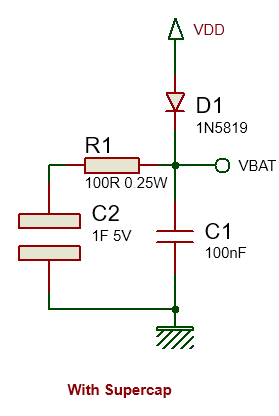

Posted on January 14, 2018 at 12:07
Yes, you are right. I found a webpage, which describes this use case. Here is a
http://embedded-lab.com/blog/stm32s-internal-rtc/
. On this webpage you can find such design:
0690X00000609NIQAY.pngRegards
Szymon

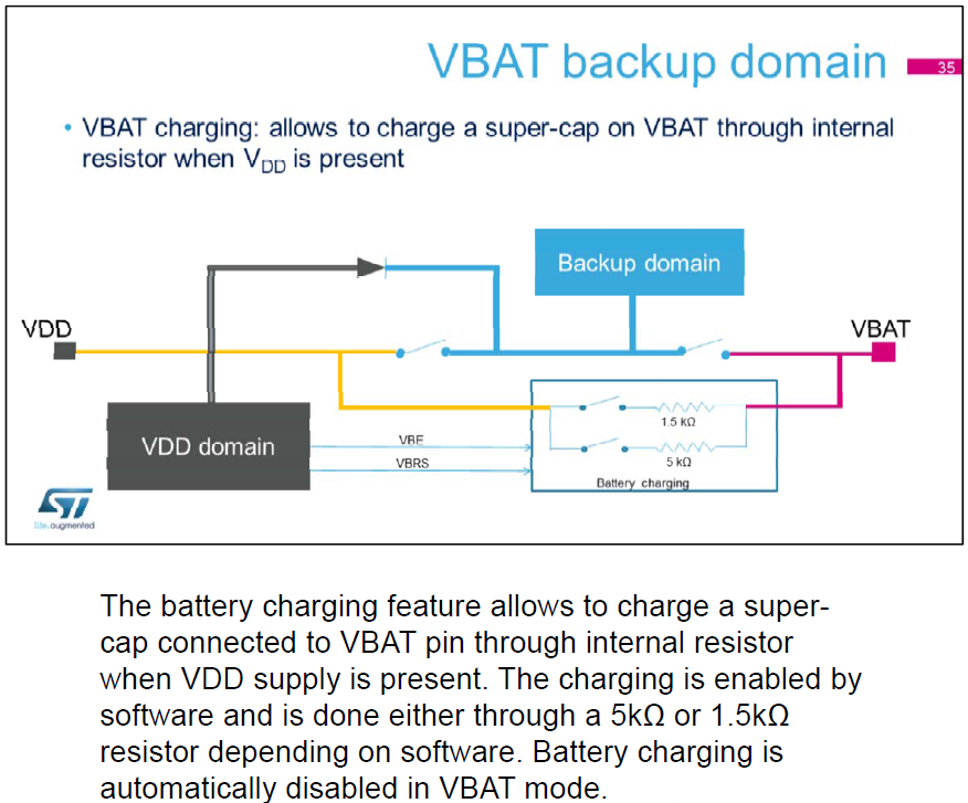

Thank you for answer. Well, can I connect directly the capacitor to the Vbat pin of Mcu as following image and call the function in order to enable battery charging module?
In the datasheet of it says that there is a internal resistor and inverse diode to vdd. So, I understand that it can charge itself without any materials.
Posted on January 14, 2018 at 13:06
Yes, you can do it. Below I attach a slide, which refers to such scenario:
0690X00000609ElQAI.pngRegards
Szymon
