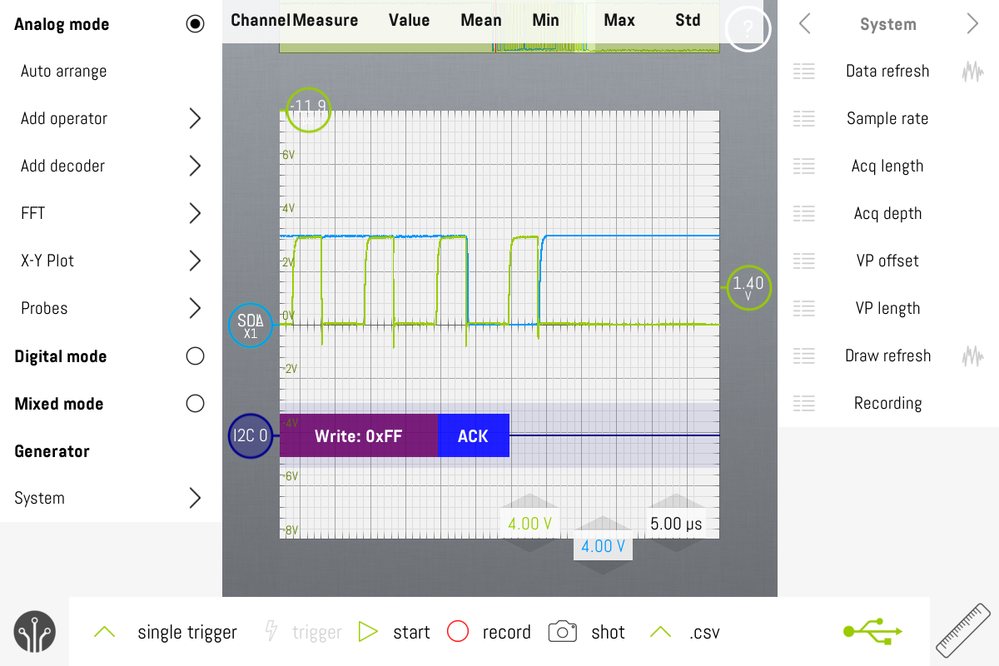

The bus (I2C1) currently, only has an eeprom connected (CAT24C512 at address 0xA0). I have two 1K pull-ups, pulling up SDA and SCL. I am attempting to operate at standard I2C speed (100KHz).
I can get an 'ack' from the device, but when trying to use HAL_I2C_Mem_Write, the micro sends the first two address bytes, then nothing. SCL stays low after the second ack (before the repeated start).
Both SDA and SCL look good.

‎2018-08-21 10:58 AM
Maybe your HAL API is different from mine (F7) but shouldn't the 4th argument to HAL_I2C_Mem_Write() be something like I2C_MEMADD_SIZE_16BIT?
‎2018-08-21 12:47 PM
Hi David,
Thank you for taking the time to answer.
Have I mis understood the HAL manual? I took the 'I2C_MEMADD_SIZE_16BIT' to mean the size of the available memory in the device (yes, I know 512K does not equate to 0xFFFF). is 'I2C_MEMADD_SIZE_16BIT' pre defined to mean the addressing mode of the device (i.e it could also be set to 8BIT)?
Many thanks,
Peter
‎2018-08-21 1:11 PM
you did indeed misunderstand. that parameter on the function call is for what size the registers on the slave are. read the data sheet for the eeprom - it probably uses 16 bit registers
