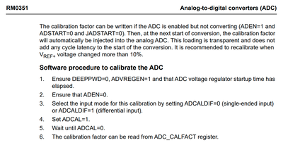

 Is there an automatic calibration routine for the STM32L471RGT6 ADC? If there isn't can someone point me to example code on how to read the internal reference (or some other approach) so I can write code to perform calibration.

The reference manual RM0351 covers calibration procedure for the ADC.

Thanks TDK,
 I followed the instructions in the manual to the letter, the ADC values changed somewhat, but they are still 10% out of calibration which seems way out. I have confirmed the VREF voltages and the input voltages to the ADC pins and added delays of 250ms between turning on the ADC and performing the calibration steps as some others have suggested . I have even hardcoded the registers - bad practice but I can't access register values directly as they don't appear in the header file. So for instance DEEPPWD is not a member of the CR register.
I'm not too sure where to go from here.
Any advice would be appreciated if you have time. Thank you.
CMSIS headers are generally comprehensive, especially on common peripherals like ADC. What registers don't exist there? DEEPPWD is defined on line 1438 here:
https://github.com/STMicroelectronics/cmsis_device_l4/blob/013bf0e41256ffbc2b539676f2007d08b297a86a/Include/stm32l471xx.h
Some general tips on ADC accuracy are here. In particular, sampling time has a large effect.
https://www.st.com/resource/en/application_note/an2834-how-to-optimize-the-adc-accuracy-in-the-stm32-mcus-stmicroelectronics.pdf
rwils.1
Thank you very much,
it is a custom board and the VREF is AVDD , it is well decoupled and stable (measured with an oscilloscope). My approach is to measure the actual voltage present on the ADC pin and calculate the expected number of counts by VIN/VDDA*4096. I confess i haven't done the obvious check of tying the pin to ground and VDDA directly , that will take some board hacking, but I will do it regardless. i think your point about ADC sampling speed is salient. I'll slow down the sampling rate and see if that changes the result at all.
i couldn't find DEEPPWD in the listing for the project CMSIS header file STM32L471x.h. After actually reading through the header file I realize it is ADC_CR_DEEPPWD. Now I understand the settings, thanks!
