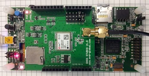

Hi, I just wanted to connect a STM32 to a GPS using a SPI with DMA. Here is my setting :
la : LOGICPORT LA1034
board : NUCLEO-L476RG
mcu : STM32L476RGT6
gps : EVA-7M
cube : 4.13.0
lib : HAL 1.3.0
clock : 80 MHz
spi : SPI3, master, full duplex, 2 wires, prescaler 256 (312 kHz), no NSS
dma : DMA2_Rq3_Ch1 as Rx, DMA2_Rq3_Ch2 as Tx, BYTE

Well with SPI the leading dummy byte on the receive is likely due to the fact you have to clock something into the device for it to respond, and you'd have to keep pumping some data out to generate clocks, as the responses will be longer than the requests.
Sorry not used uBlox devices in SPI mode, and have about zero interest in HAL/Cube. You could perhaps try using polling, or IRQ modes, to remove DMA from the equation.

How to be sure I have to clock something ?
The SPI bus is symmetrical, only transmission generates clocks, simply reading SPI->DR does not generate clocks, and thus data must be pumped across the interface for data to be retrieved.

Here attached a very simple STMCubeMX example just with basic SPI polling with no DMA that shows the problem. So it is NOT DMA related.

OK, looks like after HAL_Init(); and MX_SPI3_Init(); I have to perform a first HAL_SPI_TransmitReceive(&hspi3 of 4 bytes set to 0xFF in order to initialize the FIFOs and the TxRx register, setting MOSI and MISO high.
After that everything now looks working well. Polling or DMA. Obviously just an initialization issue that MX should have added automatically to completely set up the SPI.
