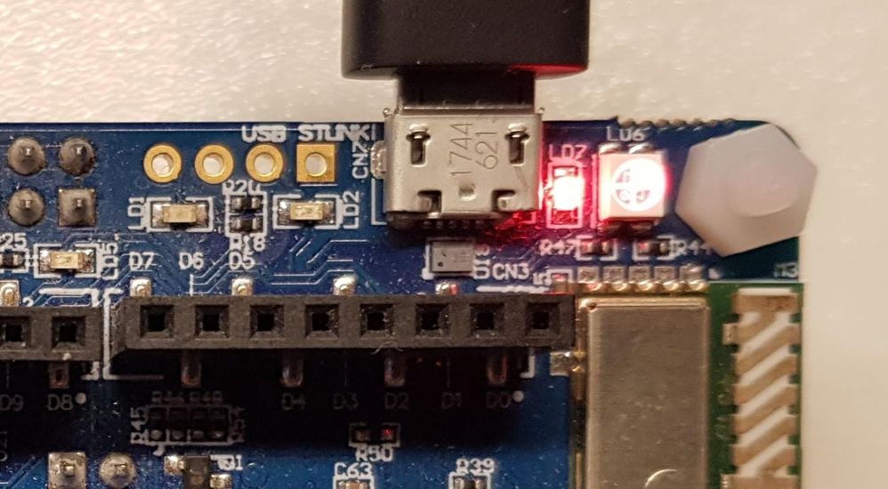

my dear STM32L4 (BL475E-IOT01A) was working until yesterday, but for an unknown reason today it does not work anymore.

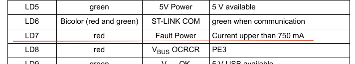

When i connect the micro usb to the ST-LINK the LD7 is turned on and remains red.
the datasheet says it is a Fault Power.

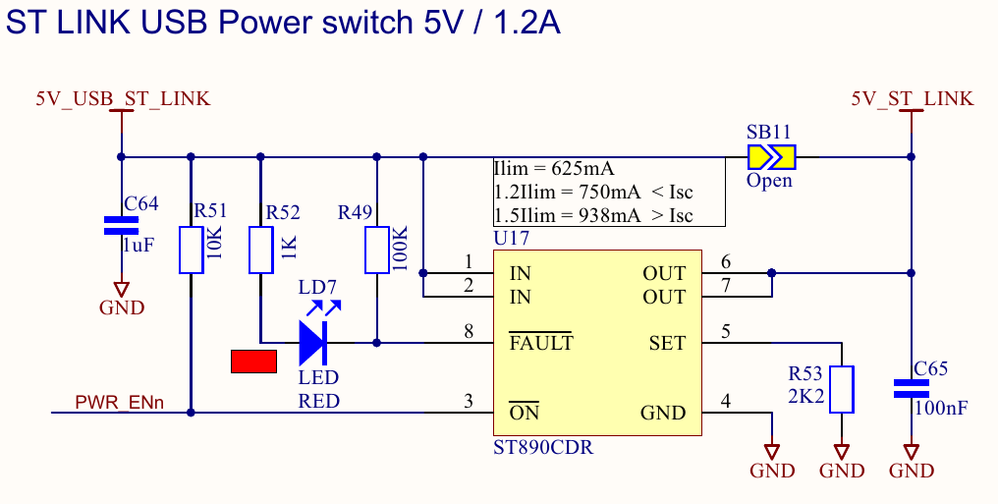

The connector is getting hot pretty fast: indeed I measured the current on the IDD pins by removing the jumper from JP5 and it reports around 650mA, which (correct me if I'm wrong) is too high.

When powered from an external power source, does the target get hot? In that case, it is broken, often caused by overvoltage on some pin.
‎2021-04-22 3:45 AM
Check the current consumption while holding the RESET button. If it's normal, then try "Connect Under Reset" and do a full erase of the MCU.

Consider you fried the STM32!
