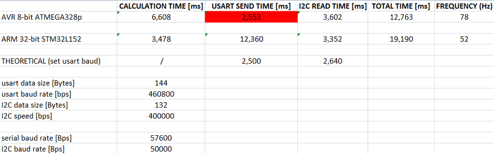

Anyway, today I have debugged the code (rather three separate modules, i.e., serial communication, I2C communication and calcultion) using the oscilloscope. I wrapped a pin toggle function around my three modules for both micro controllers and compared the results (execution time):
The only deviation between the both controllers is in the serial communication (both initialized to 115200 bps). It seems that the ARM baud is behaving properly as was initialized. Strangely, the baud rate of the AVR is 460800 bps, according to the measured time, even though it was defined also as 115200 bps. I have yet to find out why is this so. I am using the STM32L152 discovery and the AVR chip is on a standalone custom built board and the Tx and Rx pins are connected to a serial transceiver (which offers a 460800 bps maximum baud rate). I do not see how this could effect the stetted baud rate!??

chen
Posted on January 08, 2014 at 11:53
Hi K
I think you have found all the issues.
You have shown that raw processing power of the STM32 is better than the Atmel:
Calc time : Atmel - 6,608ms vs STM32 3,478ms
You have worked out why the Atmel SEEMS faster:
USART send time : Atmel 2,553ms vs STM32 12,360ms
(The Atmel does not seem to be complying with RS232 baud rate!)
''the AVR chip is on a standalone custom built board and the Tx and Rx pins are connected to a serial transceiver''
USB transceiver by any chance? USB virtual COM ports can be faster than the set baud rate!

klemen
Posted on January 09, 2014 at 12:07
regarding the CPU performance, I admit I stated this wrong. Actually I don't really care benchmarking the CPU performance. My reference is the overall let's say ''loop'' execution time.
Based on the test, it is clear that the difference is in the serial communication, although I do not know how this is possible, since the baud rates are initialized to the same value + the receiver end is initialized to the same baud. And the data on the receiver side seems ok!
I will check the clock directly on the Tx pin.
