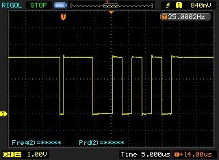

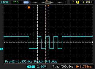

Good afternoon, I am trying to init UART5 on STM32L152 and it is work wrong.
In the end of the
sw_uart5_init
function
0xAA (0b10101010) value issent to the UART5 data register. The transmission result, registred with osciloscope not same as value sent to the data register. Can you find a mistake in the code or give me some workaround how to solve this problem?
I'm really appreciate your help. PS. The same deal with DMA, corrupted data.

Doesn't look unreasonable, there is a START bit, and the data is sent LSB first.
You are measuring two bit times. If that's wrong review how you are clocking the device, the external crystal, and HSE_VALUE definition. You should wait on TXE
while
(USART_GetFlagStatus(UART5, USART_FLAG_TXE) == RESET);

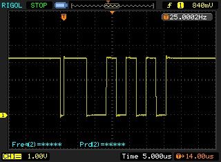

kupchykdaniil
Posted on July 29, 2014 at 12:33
Thank you for recomendation, yesterday I have changed baudrate to 115200 and detect something similar to start bit before data frame, you can see it on the pic. below.
This effect connected with uart initialization procedure, if I make a delay between uart initialization and send command to data register effect position moves relative to data frame.
How to avoid uart tx pin state change during initialization process?
ivani
Posted on July 29, 2014 at 14:10
Just move the I/O pin initialization lines after the UART initialization.
 While the UART is in reset it keeps its output signal in zero, so connecting the I/O MUX at this stage sends this zero to the output pin.

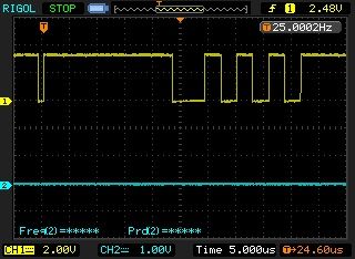

kupchykdaniil
Posted on July 29, 2014 at 14:58 I have changed GPIO initialization code position, now it's under UART init. Problem is still here and more it seems like data frame twisting around fail start. Do anyone know how to deal with it, maybe something in the code is absent?

Posted on July 29, 2014 at 15:25

kupchykdaniil
Posted on July 31, 2014 at 09:39
Thanks, fail start delay twisting less and the byte looks good by the oscilloscope.
The problem of receiving bytes on the receiver side was solved by changing HSE_VALUE variable in the ''stm32l1xx.h'' file, simply a real baudrate was wrong. By default it was 8MHz, now it fixed. I have initialized DMA on TX direction from memory to peripherial, and it works, but looks wrong - from array of 10 elements only 8 can be transferred. The last two bytes just lost. I can to create an array with size+2 and all good, but can it work normally? (I have to transfer 185 bytes, so to use interrupt routine is not a good way. )
