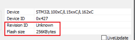

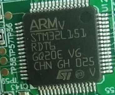

STM32L151RDT6 (SMD marked as rev V) but ST-Link utility displays "Unknown" revision ID and wrong flash size(256 isntead of 384KB) (ID_CODE = 0x10f86427) . Where I can find full list of silicon revisions of this particular MCU ?

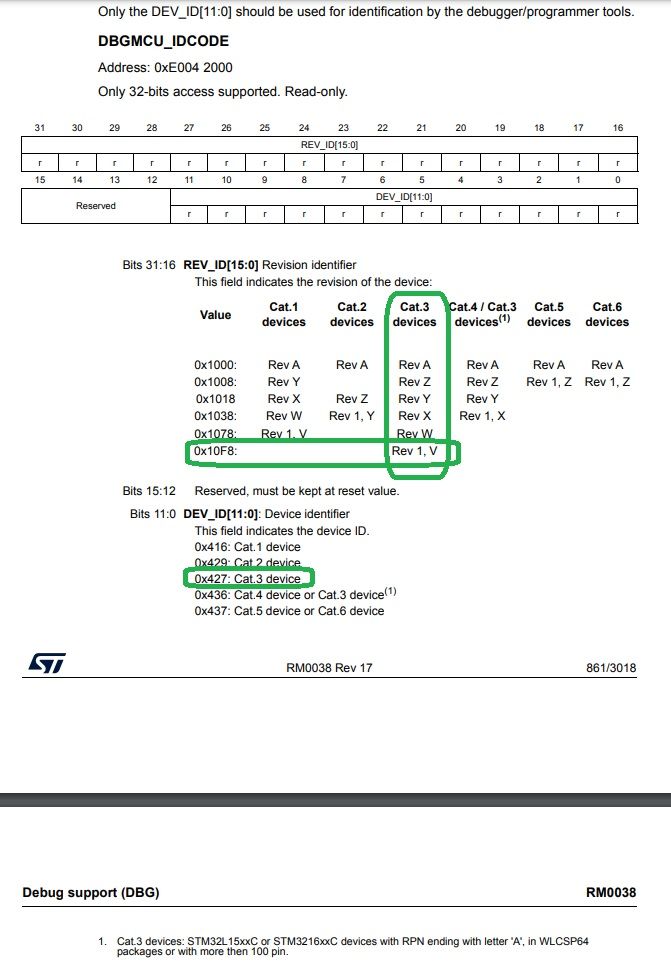

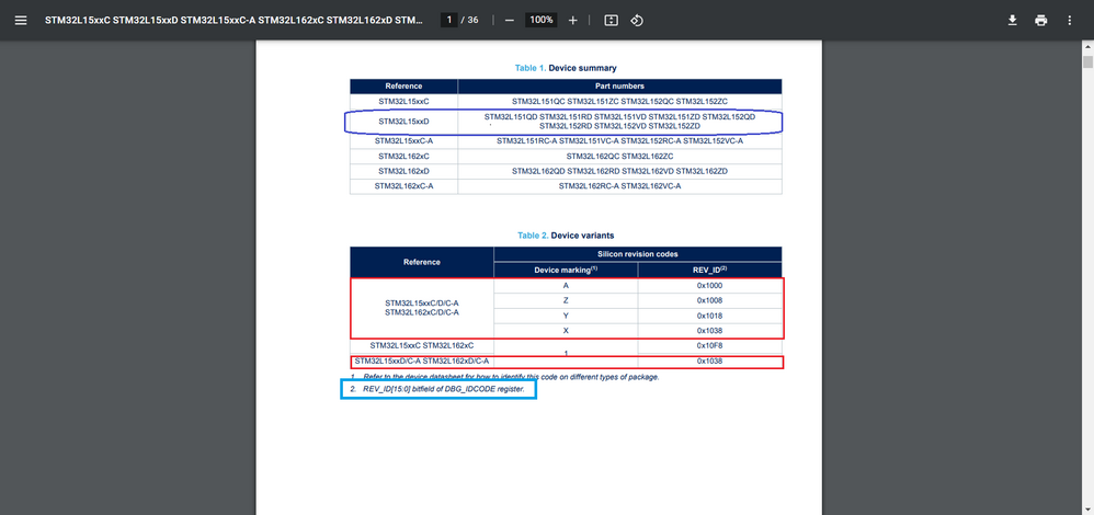

What I have noticed that for the particular MCU there is A, Z, Y, X, 1 revision (according to errata sheet) and no one has 10f8 ID CODE.
Looks like i got a clone.

Don't use the ST-LINK Utilities, it has been deprecated for several years at this point. Use STM32 Cube Programmer.
The Reference Manual and the Errata?
The RM should have details of the Chip, Stepping/Revision, and also the address in OTP to read the tested flash size from.
https://www.st.com/resource/en/reference_manual/rm0038-stm32l100xx-stm32l151xx-stm32l152xx-and-stm32l162xx-advanced-armbased-32bit-mcus-stmicroelectronics.pdf
https://www.st.com/resource/en/errata_sheet/es0240-stm32l15xxc-stm32l15xxd-stm32l15xxca-stm32l162xc-stm32l162xd-device-errata-stmicroelectronics.pdf
STM32L15xxC STM32L162xC Rev 0x10F8
Should be marked as "1" or "V", please attach a large, clear, in focus image of the part in question.

And the screenshot of document is page of ERRATA to L15xx family of devices
