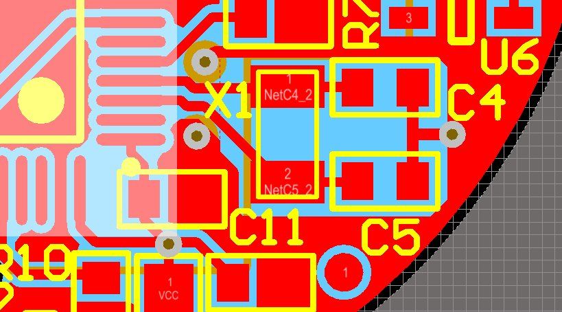

I've a design based on STM32L071CBT6, and I'm using an Abracon Crystal : ABS 07-120-32.768kHz as recommanded in AN2867.
Here's an overview on my PCB, two capacitor (C4 and C5) 2.2nF/COG/50V/5% with the oscillator X1 0690X00000603rMQAQ.jpg

I've tried to modify capacitors, 4.7pF, 10pF, or remove completly : no effet
I've add a line of code :
RCC_LSEDriveConfig(RCC_LSEDrive_
LOW
);  // Addes as mentionned in AN2867
HAL_RCC_OscConfig(&RCC_OscInitStruct);
But it doesn't work, same problem
With these small capacitance, unable to measure with scope, ... do you have idea or feedback using this crytal, or regarding this configuration
