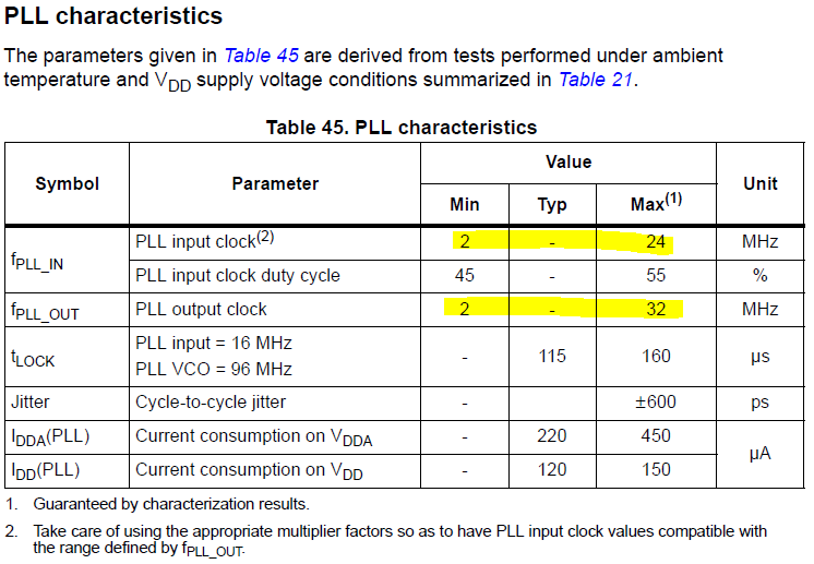

Maybe very low PLL try without it or reconfig
  RCC_OscInitStruct.PLL.PLLMUL = RCC_PLLMUL_3;
  RCC_OscInitStruct.PLL.PLLDIV = RCC_PLLDIV_2;

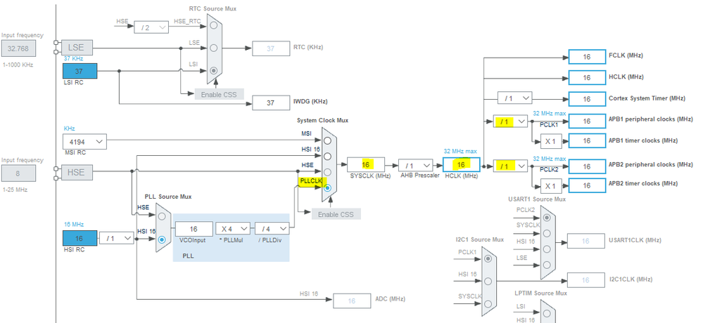

I set the MCU to 16 MHz using a PLL
0693W00000WL6MhQAL.pngwhere halt at the CPU initialization.
System Clock Configuration
System Clock source	= PLLCLK
HSI (mHz)		= 16
PLL Source		= HSI
PLL Mult		= 4
PLL Div			= 4
SYSCLK(mHz)		= 16
HCLK(mHz)		= 16
AHB Prescaler		= 1
APB1 Prescaler		= 1
APB2 Prescaler		= 1
VDD(V)			= 3.3

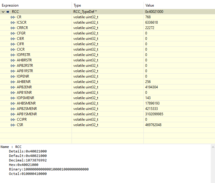

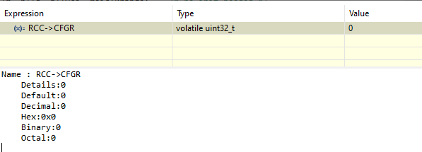

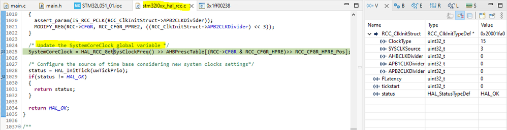

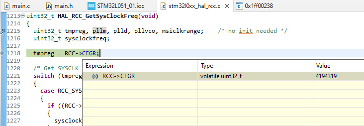

I decided to dig deeper and figure out exactly where it freezes
0693W00000WL6SmQAL.pngthen -> could not pass RCC->CFGR
0693W00000WL6URQA1.pngCurrent values:
The complete project is attached as well.
