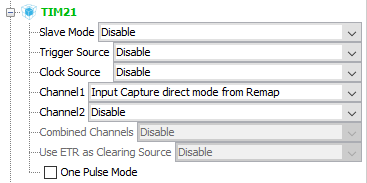

Hi! I have an STM32L0 nucleo board and I want to calibrate HSI using LSE; I have read the application note: AN4631 that explain a solution: at page 12 is possible to see the Hardware connection with TIM21 CH1 in capture/compare configuration;
But... I don't knew how to translate this info into CUBE-MX configurator for a correct result
Could you please tell me how to set it? please help me, thank you very very much.

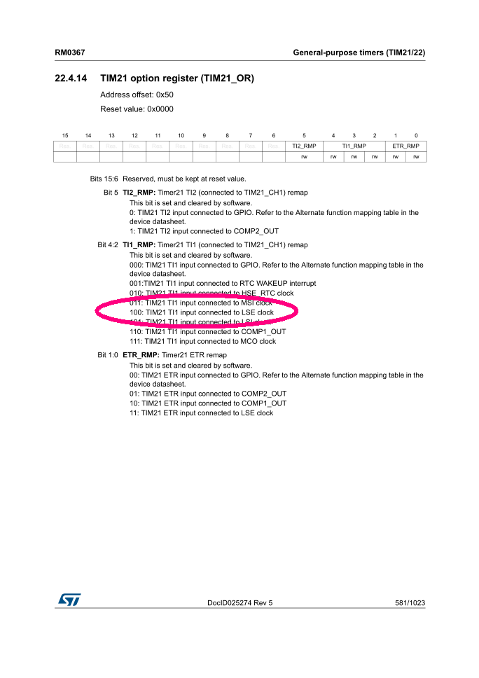

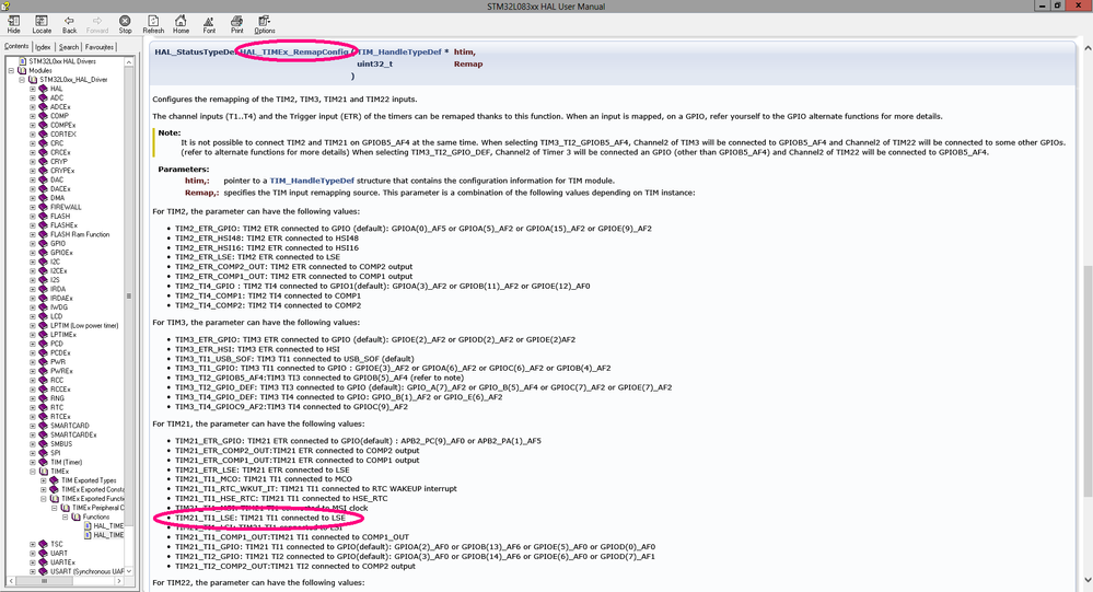

I don't use CubeMX so I don't know how to click it in there, but it's only about setting the TIM21_OR register.
Looking into Cube's sources,  this should be the incantation to use:

Well, I was able to associate the LSE clock source to channel 1 of the timer,
It was enabled by the HAL function:
HAL_TIM_IC_Start_IT(&htim21,TIM_CHANNEL_1);
and I have verified that it works fine.

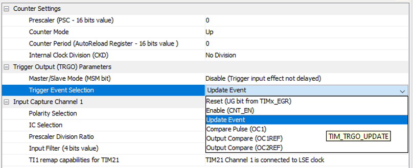

Now: I associated to ''Trigger Event Selection'' : Update Event.
And for each tick of the LSE I get an interrupt, managed in the routine:
TIM21_IRQHandler(void);
Here all the possible configurations:
And I don't knew what is the best solution to obtainting a correct HSI calibration from the LSE.

You don't need that second step, setting TRGO  - that would be used if you'd want to link internally some other timer to TIM21.
The method is roughly correct - in the interrupt, you count up to 32768 and then read out the capture register (TIM21_CCR1) to find out the number of HSI ticks. This all is assuming there is no PLL used and there is no divider on the APB buses.
As there will be some setup time, it's better to read out the CCR1 in the first and then in the 32769th interrupt and subtract them.
Note that the dependency of HSI16 frequency on the HSI16CAL is nonlinear, 'jumping' down by typ. 1.5% every 16 values; and even between the 'jumps' the 'tuning step' of HSI16 is rather large, typ. 0.4%, so out of 4000000 it's more 16000 than 10.
