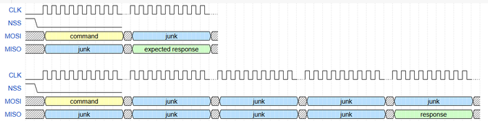

We have been trying to use the STM32H747I-DISCO to act as a SPI slave which should respond to a command byte, behaving similarly to how a sensor or EEPROM might.
That is, the fist byte sent from the master will be a command and our slave device should respond to this command. Unfortunately, the best we are able to do is respond to this command 3 bytes late.
In the following, the top is what we'd like, the bottom is what we are currently seeing.
It appears that to get the slave to send back any data, the TXFIFO must have at least 32-bits loaded into it at the start of the transfer, it doesn't matter if I do this via a single 32-bit register write
hspi5.Instance->TXDR = 0x89ABCDEF // 32 bits of "junk"
or 4, 8-bit writes
*(volatile uint8_t *)hspi5.Instance->TXDR = 0x89 // "junk" byte 1
*(volatile uint8_t *)hspi5.Instance->TXDR = 0xAB // "junk" byte 2
*(volatile uint8_t *)hspi5.Instance->TXDR = 0xCD // "junk" byte 3
*(volatile uint8_t *)hspi5.Instance->TXDR = 0xEF // "junk" byte 4
Either way, we see the behavior in the bottom half of the image.

We only see
The `0xAB` of the 1st load to the TXFIFO works, but the second (setting it to `0xCD`) doesn't, instead sending out `0xFF` on MISO until the end of the transfer.

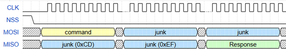

I was wrong about 32-bits needing to be loaded. 16-bit is enough, and makes it so that I am only 1 byte late. This is still an issue, but does point to it being a race condition with the peripheral instead of something with the FIFO I'd think?

‎2024-06-26 6:30 AM - edited ‎2024-06-26 6:39 AM
We have found that doing
MODIFY_REG(hspi5.Instance->CFG1, SPI_CFG1_UDRCFG, 0);
MODIFY_REG(hspi5.Instance->CFG1, SPI_CFG1_UDRDET, 1);
At the end of our init function allows us to operate in 8-bit mode correctly (as in, we can respond in the 1st byte) however, it's very slow. We also don't understand why this is helping. If we load data to UDRDR, we never see it. (Note that Setting UDRCFG to 0b00 should be the mode where UDRDR is used on underrun) and I don't understand why the setting of UDRDET would matter here either.
If only setting one "junk" tx byte, allowing for responding correctly, we can only get reliable SPI communication up to ~2Mhz. Adding one extra junk byte - letting there be two bytes in the buffer - let's us operate above 10Mhz.
// Disable and re-enable the SPI peripheral
CLEAR_BIT(hspi5.Instance->CR1, SPI_CR1_SPE);
SET_BIT(hspi5.Instance->CR1, SPI_CR1_SPE);
#if 0
// If we do only 1 byte, max 2Mhz
*spi_tx_ptr = 0x89 // Single junk byte
#else
// If we do 2 bytes, max 10+Mhz
*spi_tx_ptr = 0xCD // "junk" byte 1
*spi_tx_ptr = 0xEF // "junk" byte 2
#endif
// Wait for RXP (blocking)
while ((hspi5.Instance->SR & SPI_FLAG_RXP) == 0);
// ... Code from the original post
In short, 8-bits works but is only reliable up to 2Mhz master clock. Using 16-bits is fast enough but this still makes us a byte late,
As I still need the response to be where we're seeing the 2nd (0xEF, in this example) "junk" byte on MISO.
