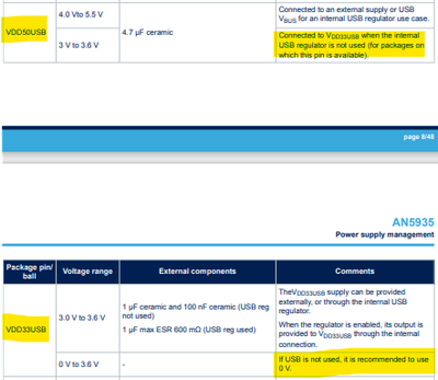

Hello Team,
One more query is there.
We are not using USB. In STM32H7S7L8H6 pin D9-VDD50USB is there. So, can we connect it with 3.3V supply?

Hello @JK1234 ;
I recommend you to look at AN5935 application note Table 4. Power supply connection.
If USB is not used, it is recommended to VDD33USB 0V.
And when the internal USB regulator is not use , the VDD50USB must be connected to VDD33USB.

Hello @KDJEM.1 ,
Thanks for the update.
We are not using USB. As per my understanding we need to connect Pin-D9(VDD50USB) & Pin-F8(VDD33USB) with GND right?

Hello @JK1234 ;
Yes you are right.

Hi, I haven't connected the VDD50USB to VDD33USB , connect VDD33USB to GND and  leave VDD50USB unconnected . While I don't use the internal USB regulator, is it OK?
