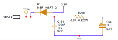

Query related to VBAT. Please refer below capture and provide your feedback for VBAT. Diode D1 and other components are, ok?

Power dissipated by R218 if C56 is 0V is around 1.5 W which greatly exceeds the rated power value. Is C56 okay being charged at 500 mA? Can your 3.3V rail even supply that much excess current?
Generally want a much slower charge rate by increasing R218.
Diode reverse current seems a bit high. Probably better choices, but maybe it's good enough for your application.

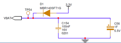

If we do not use R218 and connect direct connect it with VBAT pin via D1 diode than it is, ok? Refer below image.

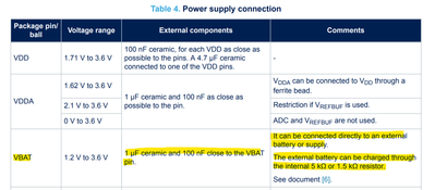

I recommend you to look at AN5935 application note Table 4. Power supply connection and Figure 3. Power supply component layout. The values of the two capacitors are 1 µF ceramic and 100 nF not 1F and 100 nF.

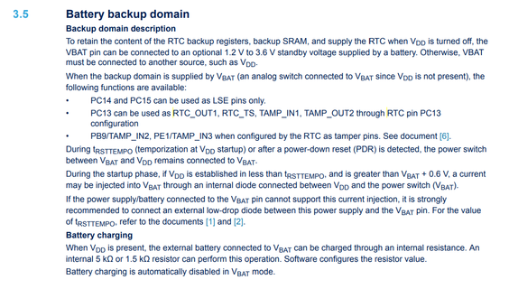

Do you need more hardware information about how to retain the content of the RTC backup register?
Please look at 3.5 Battery charging domain.
Thank you.

Do you have tools available to simulate this circuit? I suggest using those to see the effect of removing R218.
