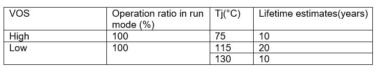

Please forget about the previous tables. This is an updated estimated lifetime table for H7RS no matter the mission profile is:
AN5337 will be updated in 2026. We don't have the exact deadline at the moment.

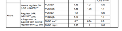

This kind of information can be found in the datasheet but seems only two voltage levels are available (low and high)

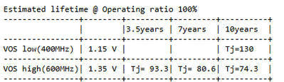

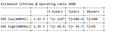

The estimation of the current profile is given in the Table below.
The target for the industrial mission profile is given below also.
Estimated lifetime @ Operating ratio 100%
Hope that helps.

@mƎALLEm but the first table says
10 years with VOS high and Tj=55°C
and the second table
10 years with VOS high and Tj=74.3°C
what is the difference between the two tables if it is not the grade of the chip? How is "industrial mission profile" defined in that context?
