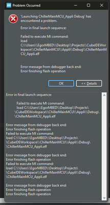

I’m working with an STM32H7R7I8 MCU and an external W25Q128JV QSPI Flash connected to XSPI2 --NCS1 -- Port1.
The Flash memory is wired correctly (pins verified) and the Chip Select line (NCS1) idles high after power-up (I've used 10k pull up resistor on flash cs pin.
However, when I try to access or program the Flash (using CubeProgrammer or Cube IDE), there is no activity on any QSPI lines — confirmed with a logic analyzer.
My setup:
  • XSPI2 (Quad mode)
  • NCS1 connected and configured as "Chip Select Override NCS1 -- Port1"
  • Flash base address: 0x70000000
  • Firmware generated using STM32CubeIDE 1.19.0
  • The memory is initialized via HAL MX_XSPI2_Init()
  • MPU configured with:
    • Region 0 (4 GB, default)
    • Region 1 for 0x70000000, 16 MB, full access, executable
When I enable the MPU (HAL_MPU_Enable()), the MCU immediately triggers a HardFault, and the LR = 0xFFFFFFF9 (return from interrupt).
If I disable the MPU, the code runs, but the Flash is still completely silent — no CLK or CS activity visible.

When trying to run Debug from CUBE IDE:
Log from terminal:
ST-LINK SN : 0D000F00182D373637365744
ST-LINK FW : V2J46S7
Board : --
Voltage : 3.20V
SWD freq : 4000 KHz
Connect mode: Under Reset
Reset mode : Hardware reset
Device ID : 0x485
Revision ID : Rev Y
Device name : STM32H7RSxx
Flash size : 64 KBytes (default)
Device type : MCU
Device CPU : Cortex-M7
BL Version : 0xE3
Opening and parsing file: ST-LINK_GDB_server_a01600.srec
Memory Programming ...
File : ST-LINK_GDB_server_a01600.srec
Address : 0x70000000
Erasing external memory sectors [0 16]
Error: failed to erase memory
Encountered Error when opening C:\ST\STM32CubeIDE_1.19.0\STM32CubeIDE\plugins\com.st.stm32cube.ide.mcu.externaltools.cubeprogrammer.win32_2.2.200.202503041107\tools\bin\STM32_Programmer_CLI.exe
------ Switching context -----
Error in STM32CubeProgrammer

Question:
What could cause no XSPI2 activity at all on STM32H7R7, even though the peripheral is initialized and clocks are enabled?
Could this be related to MPU configuration, XSPI2 domain, or CubeIDE code generation issues? Also I attach my .ioc file, hope that will be helpful
1 REPLY 1
AScha.3
you have a board to compare, like Nucleo-H7S3 with qspi flash ?
