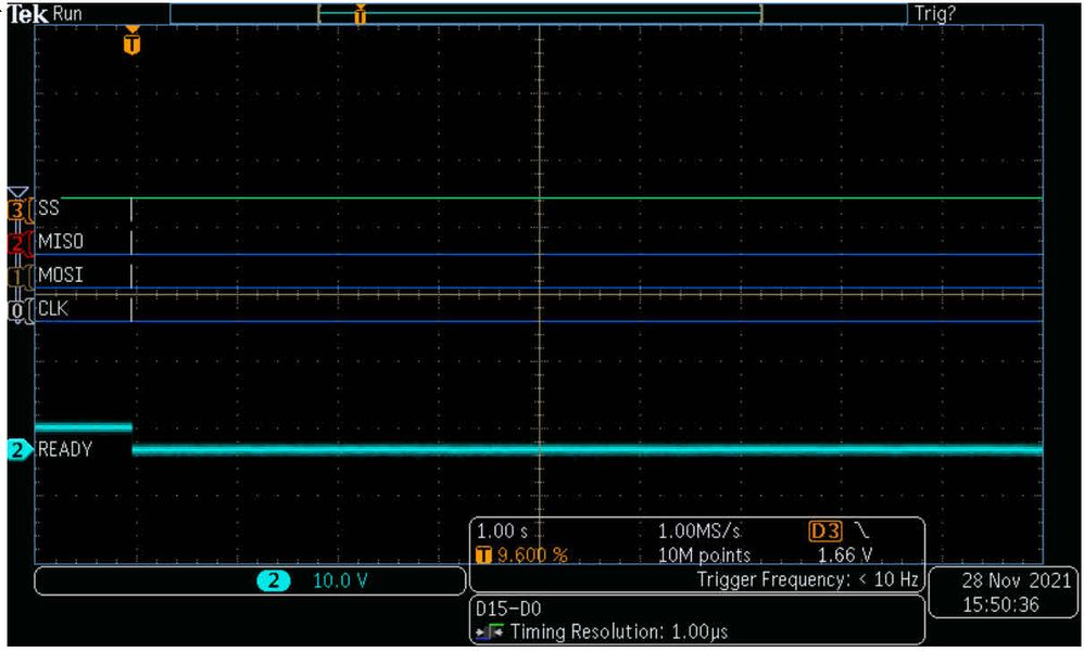

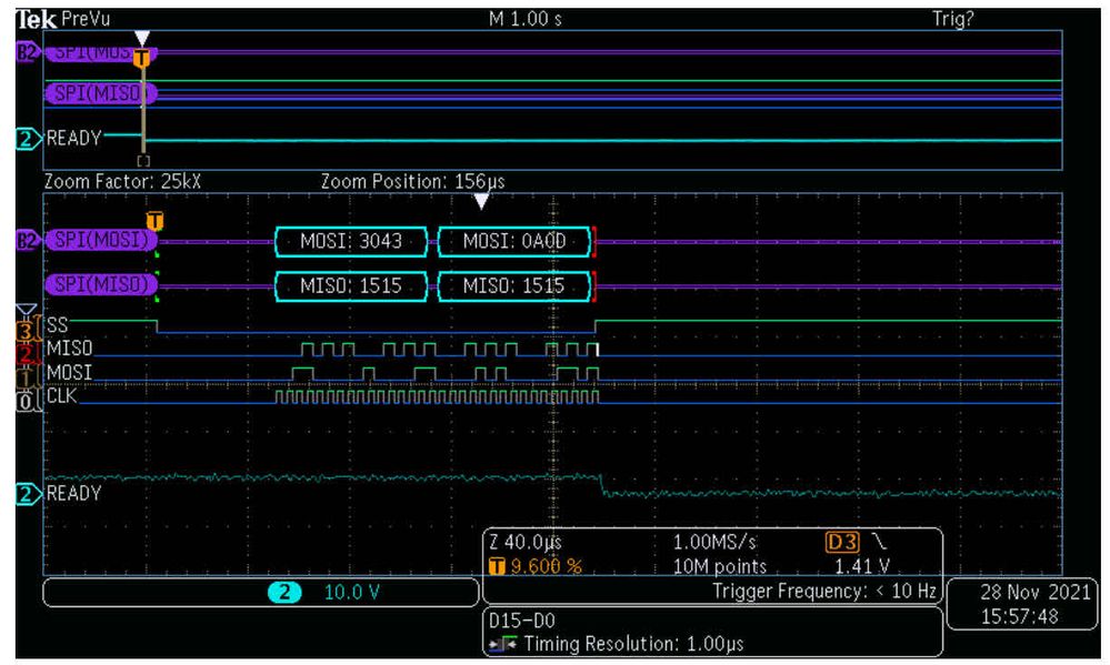

I can send the device AT commands and get back the OK response, but after setting the network parameters SSID, password, security mode, DHCP after issuing the Join Network command "C0" the module ready line goes low and never sets back to ready.
Overall Response of C0 Cmd
SPI Bus Detail of C0 Cmd

So I am confident the SPI bus is working OK

Regarding the Join problem, there *may* be a problem if your WiFi access point uses 2.4 GHz Wifi channel number higher than channel 11.
By default the Inventek Firmware is configured to be in "US" country which forbids WiFi channels higher than 11.
if it is the case, then you have to set the Country to something other than US. it's Inventek AT command "CN". Use "CN=?" to know which values are acceptable. Try something like CN=CA/0 or CN=FR/0. Or change the channel on your WiFi access point to something lower than 12.

‎2021-12-17 12:32 AM
Thanks very much for that. I hadn't thought about the channel numbers - silly me.
I checked my router on my android phone and found it is running on channel 13. So there's a very good chance that the channel is the problem.

‎2021-12-17 10:09 PM
Hi Guillaume K,
I used the CN command to set the Country Code to "AU", but this was rejected as "Unknown."
It turns out the latest firmware only supports: C3.5.2.5 or greater now limited to CR,FR(EU),US,JP(43362 only).
Fortunately Australia uses 1-13 like the EU so setting the country code to FR(ance) got everything going.
