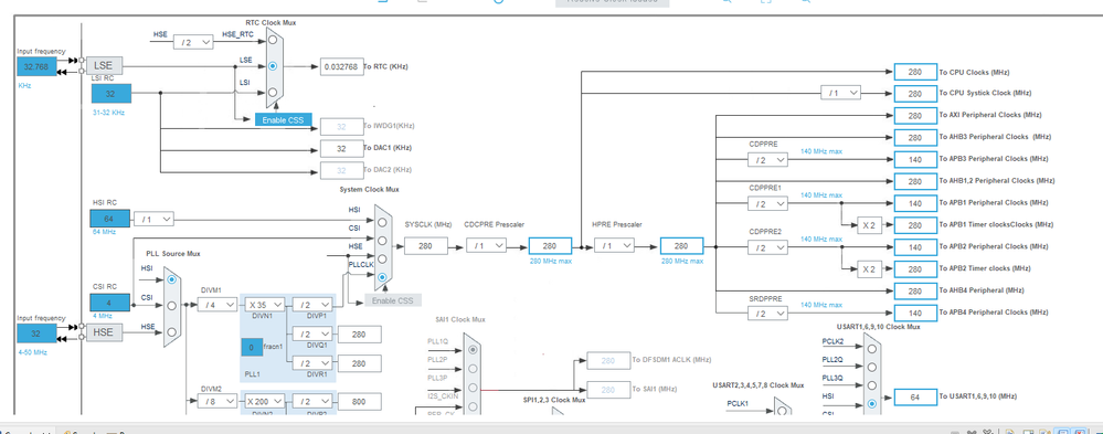

I run the MCU on 280 Mhz:
0693W00000Y92EsQAJ.pngIn Pinout & Configuration -> DEBUG I configured Serial Wire as debug interface.

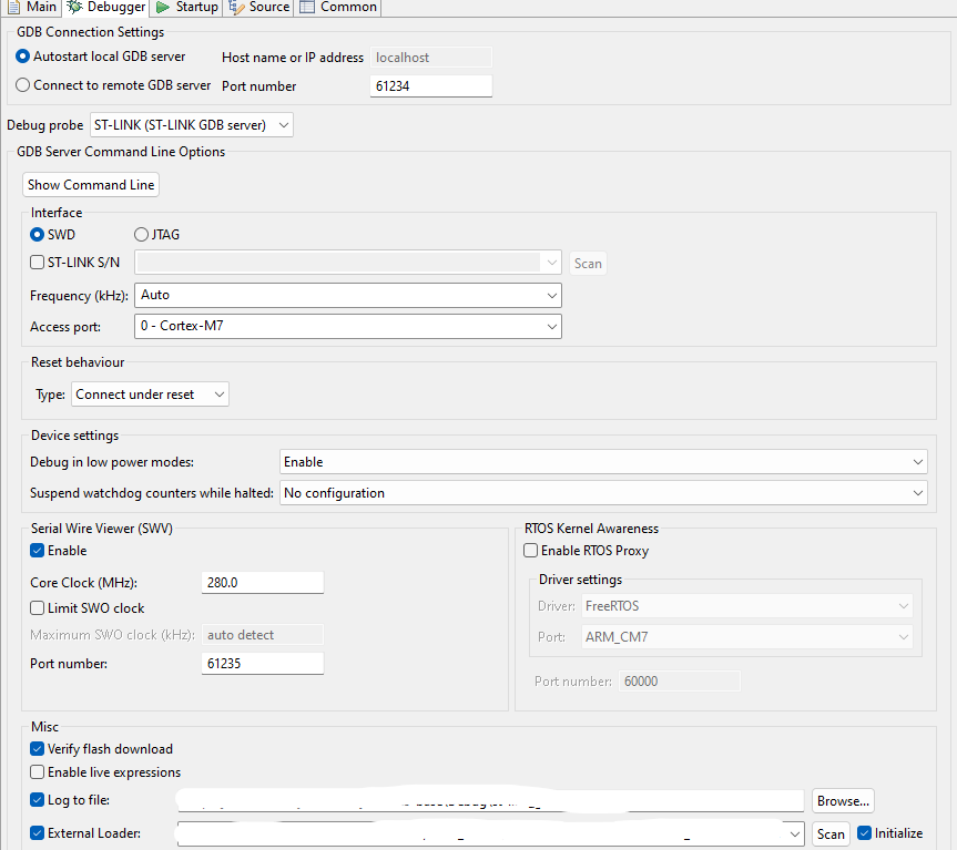

 My debug configuration looks like this:

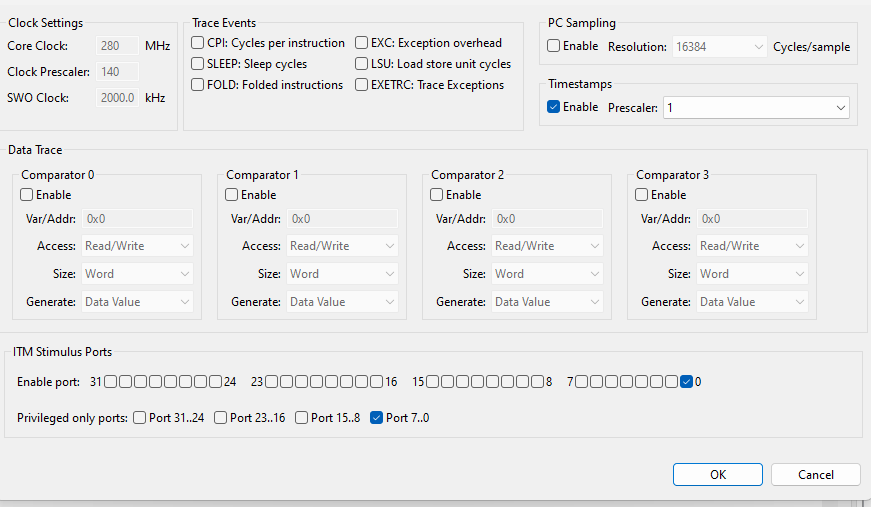

0693W00000Y92H3QAJ.pngAnd my SWV ITM configuration looks like this:
Please help me figure out how to get it up and running, because I'm getting frustrated after all my failures in tutorials.

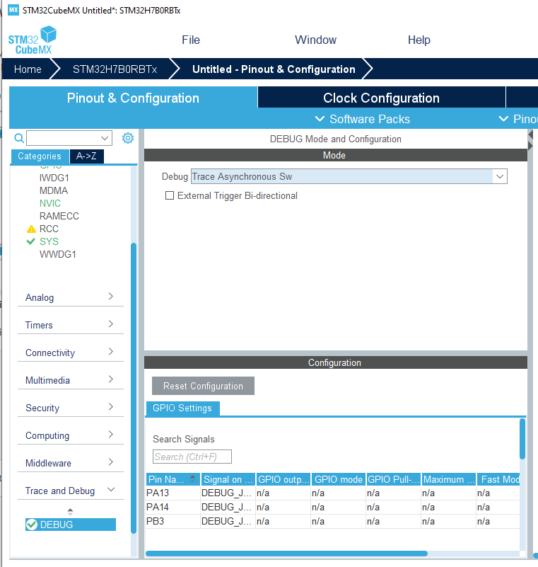

"In Pinout & Configuration -> DEBUG I configured Serial Wire as debug interface."
You must set Trace Asynchronous SWO with PB3 as JTDO-SWO.
0693W00000Y92NkQAJ.pngRegards,
Romain,
In order to give better visibility on the answered topics, please click on 'Select as Best' on the reply which solved your issue or answered your question. See also 'Best Answers'
Hi Romain,
I tired also this option but the result was the same - empty SWV ITM Data Console. Have you got any other idea?

i tried many hours, until i see something... so dont be surprised to get nothing at first.
  1. you have set >>  Trace Asynchronous SWO << ?
  2. you connected SWO to STlink SWD input ?
  3. your STlink is original V2 or V3 ?
  4. set speed in debug configuration ? max. 2 MHz for V2 , or >> auto detect <<
  5. click (in debug mode - at start) red trace/start button ? (if bright red, dark red = not active)
  6. in opened view console for text, graph or timing ?
  7. you can only start trace , when debug paused !
  8. sometimes not working, try : pause debug, click >once on red start button, run debug again....
(is buggy, not really reliable ; but when working, is very useful... )
  1. Yes, I set Trace Asynchronous SWO - still no result.
  2. Yes, these two are connected.
  3. Original STLink V2.
  4. As you can see on the screenshot from debug configuration STLink's speed is set to "auto detect"
  5. Yes, the button is clicked and trace started.
  6. Don't understand what do you mean by that. I open ITM Data Console and it remains empty.
  7. I start trace on the start of the debug (default breakpoint in main()). The MCU is halted.

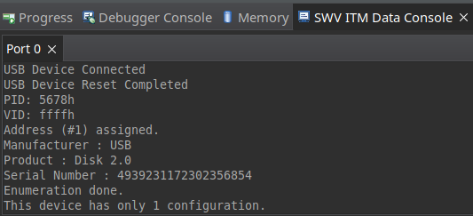

this is, what comes from USB host , with debug on:
0693W00000Y9AA0QAN.png+ i didnt click red button or anything, still setup is running like i set it 3 days ago , on last debug of this project.
