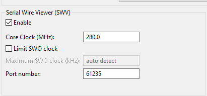

0693W00000Y92H3QAJ.pngAnd my SWV ITM configuration looks like this:
Please help me figure out how to get it up and running, because I'm getting frustrated after all my failures in tutorials.

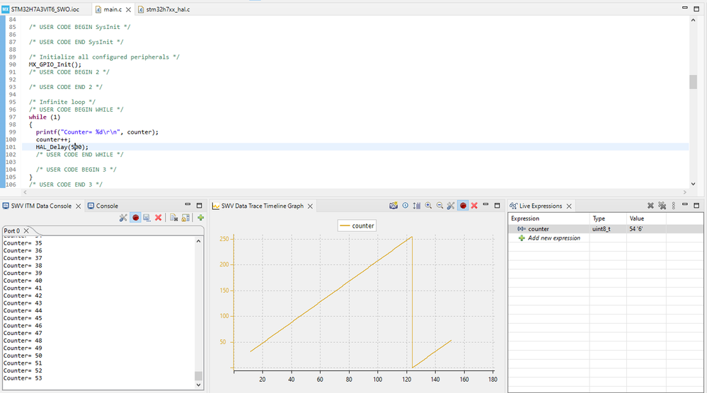

I successfully tested printf stdio redirected to ITM SWO on STM32H7A3VIT on custom board with STLinkV2-1 standalone and STM32CubeIDE v1.11.0 (but it also works with v1.9.0)
Here a screenshot of SWV ITM Data Console, SWV Data Trace Timeline Graph and Live Expression:
0693W00000Y9DbYQAV.pngI can suggest to check following point:

If you have syscalls.c in your project, simply re define __io_putchar in the main.c.
/* USER CODE BEGIN 4 */
int __io_putchar(int ch)
 ITM_SendChar(ch);
 return(ch);
/* USER CODE END 4 */
Include stdio.h header and your code to printf and increment counter variable.
#include "stdio.h"
/* USER CODE END Includes */
/* USER CODE BEGIN PV */
uint8_t counter = 0;
/* USER CODE END PV */
/* Infinite loop */
  /* USER CODE BEGIN WHILE */
  while (1)
    printf("Counter= %d\r\n", counter);
    counter++;
    HAL_Delay(500);
    /* USER CODE END WHILE */
    /* USER CODE BEGIN 3 */
  /* USER CODE END 3 */
In the debug configuration, enable SWV with the same CPU clock (280MHz)

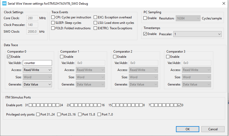

0693W00000Y9DdoQAF.pngLaunch the debugger, open SWV ITM Data Console, enable ITM Stimulus Ports 0 (optionally set counter variable in data trace comparator)

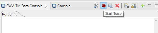

0693W00000Y9DewQAF.pngStart Trace (red button icon) and resume debugger.

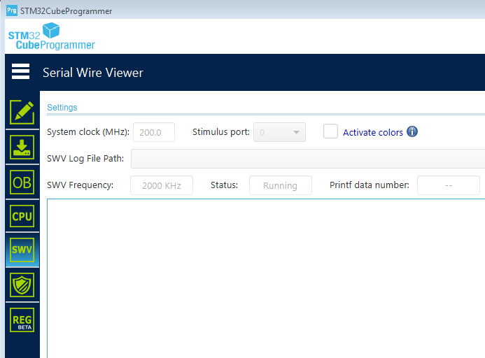

I have the last question. Is there some simple way to access SWO data from localhost:61235? I tried connecting to that port using PuTTy but without any success :(
Regards,
Piotr
AScha.3
putty :)
you need a "debug" connection; new version of Cube programmer should work...(i didnt test)
