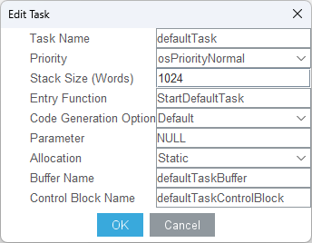

I have also added the configuration.
Maybe someone here can see at first glance what was configured incorrectly.

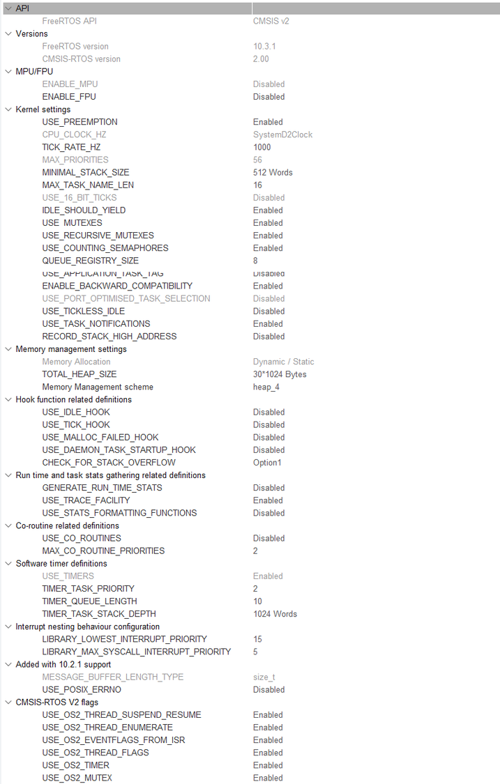

FreeRTOS M4 Configuration

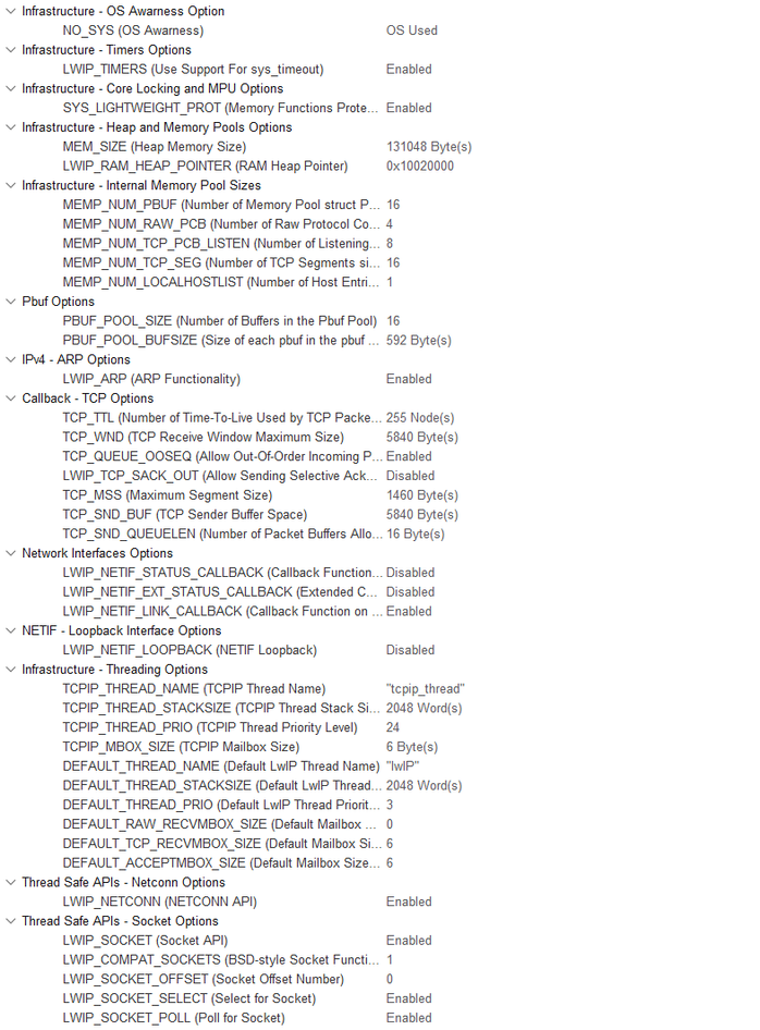

LWIP Configuration
