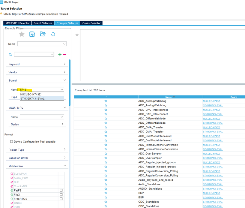

There are many examples you can look at. Just use the example selector in STM32CubeIDE and select the H743 as it is the same as the H753
