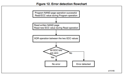

About the documentation, as mentioned in section ECC result registers (FMC_ECCR), when the CPU reads or writes data from the NAND flash memory, the ECC computation module automatically processes the data and generates a new set of parity bits. The CPU then reads the computed ECC value from the FMC_ECC registers and compares it with the parity value recorded in the spare area. The error correction code algorithm implemented in the FMC can perform 1-bit error correction and 2-bit error detection per page read from or written to the NAND Flash memory. It is based on the Hamming algorithm and consists in calculating the row and column parity.
I suggest taking a look to Using the high-density STM32F30xxD/E FMC peripheral to drive external memories
section 4.4 Error correction code computation for further details.
