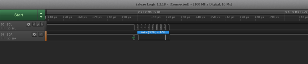

I recently need to use I2C with interrupt mode to lower my CPU usage.
So I did this changes :
I changed the function where I call my transmit
static HAL_StatusTypeDef PGA309_Write_RawData(uint8_t REGISTER,uint8_t LSB_DATA,uint8_t MSB_DATA)
	uint16_t i = 0;
	I2C1_TxBuffer[i++]= REGISTER; //First data : Set register address
	I2C1_TxBuffer[i++]= LSB_DATA; //Second data : LSB value
	I2C1_TxBuffer[i++]= MSB_DATA; //Third data : MSB value
	//return HAL_I2C_Master_Transmit(&hi2c4, (uint16_t)PGA309_SLAVE_ID, I2C1_TxBuffer, i, (uint32_t)100);
	return HAL_I2C_Master_Transmit_IT(&hi2c4, (uint16_t)PGA309_SLAVE_ID, I2C1_TxBuffer, i);
I added NVIC stuff to HAL_I2C_MspInit()

But shortly after I call Transmit_IT my CPU ends up stuck here :
 * @brief  This is the code that gets called when the processor receives an
 *         unexpected interrupt.  This simply enters an infinite loop, preserving
 *         the system state for examination by a debugger.
 * @param  None
 * @retval None
    .section  .text.Default_Handler,"ax",%progbits
Default_Handler:
Infinite_Loop:
  b  Infinite_Loop
  .size  Default_Handler, .-Default_Handler
It looks like my I2C peripheral is sending an unexpected interrupt, am I missing some init parameters ?
Gabriel T
Senior
I added this to my main and it works now
extern void I2C4_EV_IRQHandler()
    HAL_I2C_EV_IRQHandler(&hi2c4);

Also, I am only sending the first byte
