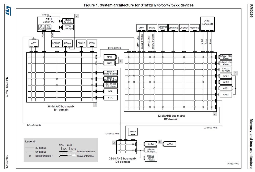

I am planning to run a RAM test on STM32h743 RAM module. But I noticed that the RAM is divided into 3(SRAM 1,2,3) .Are these three RAMs physically different or the same RAM divided into three modules.

Distinct arrays, on the same silicon, multiple buses to reduce contention. Actually more RAM than those 3, also SRAM4, AXI RAM, ITCM RAM, DTCM RAM
DFuchs
I treat them as different RAMs because they have their own row and column decoder.
