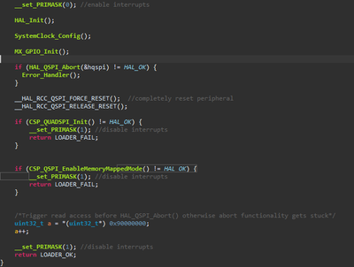

the Loader_Src.c Init() is only called in the entry and resets and initializes the quadspi so I wouldn't think it would need QSPI Abort in there. The loader does call QSPI Abort before write, erase is done. Maybe I'm missing something in what you are suggesting.
‎2024-02-19 3:27 PM
Since the programmer successfully reads the flash when it initially connects, what does the programmer do when the READ button is pressed that it would fail? I would think the loader is still in memory mapped mode since the HAL_QSPI_Abort() is only called at the beginning of the Write and Erase functions of the loader.
The loader example I'm using only enables memory mapped mode in the Init and Verify functions, should this be done somewhere else for the READ to work or does the READ just call the Init() of the loader?

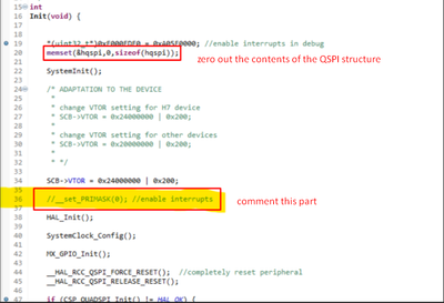

Found a resolution for this issue...
Apparently the enabling interrupts in the Init() function of the Loader_Src.c provided in the ST repository for the H7 external loader was hanging after it entered this function the first time. Made the modifications below per ST suggestion...
Once this was done however the HAL_Delay() in my QuadSPI drivers would hang (made sense since interrupts are disabled I guess) so I also had to include a local HAL_Delay() function that used NOP instead of ticks.
I added this in my quadspi.c file...
ST support is still looking into whey the enabling of interrupts is hanging in this case.

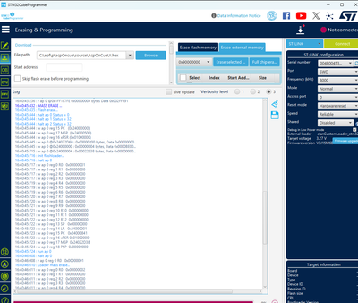

Tesla I have a mostly working external loader I developed for the Windbond W25Q64JV but for some reason the "Erase Chip" function for the external flash fails with the STM32Programmer as seen below...
This function works fine with the loader you provided for me (CLIVEONE-W25Q64_STM32H7XX-PB2-PB6-PD11-PF9-PE2-PA1.stldr) back in May 2023. Could you share your W25Q64 driver code with me so I can see what is wrong with mine?
‎2024-12-09 1:00 PM
If it returns immediately with an error, instrument to determine why.
For example the QSPI functions return an error due to being in Memory Mapped mode.
The device can complete immediately if protection bits are set, but this usually means it exits the Wait Complete early, but with no error returned.
Use Verbose Level 3 to see what the MassErase() call is returning to STM32 Cube Programmer

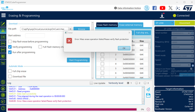

‎2024-12-09 2:43 PM - edited ‎2024-12-09 2:46 PM
Thanks for the response....
I've tried to increment some counters in RAM to see if I'm getting any errors from the QSPI HAL functions but it doesn't seem to be telling me anything.
It does not return immediately as a failure, spends about 15sec or so trying to do the erase.

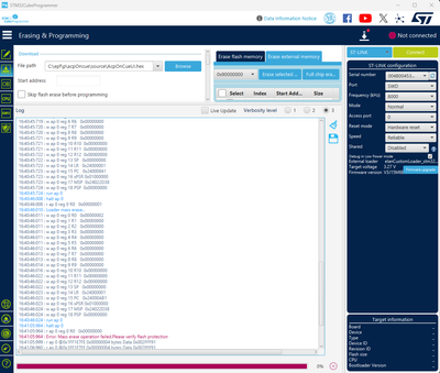

When I set the Verbosity Level to 3 the first time it successfully completed the mass erase...but now fails again. I attached the log file
The Sector Erase works fine and I could've sworn the mass erase worked fine too when I tested this back in April, but now that I have a new laptop and installed a newer version of the STM32Programmer it fails.
