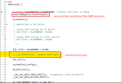

I went through the ST External QSPI Loader how to and have verified my quadspi.c/h driver is good with the Winbond W25Q64 flash part we are using. However after I create the .stldr and load it into the STM32 Programmer it will not read from the flash...get Error:data read failed. I've attached the project if someone could help me out with what could be wrong?

Just to wrap up the solution to this LONG thread....
Initially I was using TIM6 for the timebase (based on application using FreeRTOS that cannot use SysTick) but the NVIC priority was set to 15. I'm not sure if the priority was the problem or some timeout with the Loader_Src.c Init() function, but the ST Support solution to comment out __set_PRIMASK(0); that enabled interrupts just masked the issue and since the interrupts were no longer running the HAL_GetTick() never incremented so timeout values made no difference and I had HAL_Delay() overridden to use a loop of NOP.
By using SysTick for the Timebase and setting it's NVIC priority to 0 instead of 15 (default) I was able to use enable interrupts in Init() and use the standard HAL_Delay() and HAL_GetTick() just fine and almost everything worked just fine. However, the Chip Erase still failed....Tesla was correct that this was a timeout issue. Basically, I had a timeout value of 20000 (HAL_QSPI_TIMEOUT_DEFAULT_VALUE) I was using for most the QSPI functions. I started using a larger value for erasing the chip, but I was using this larger timeout for issuing the erase chip command when in fact the HAL_QSPI_AutoPolling() is what needed the larger timeout value since that is what is waiting for the erase to complete. Once I modified my AutoPolling function to use a larger timeout when doing a chip erase then that method started working as well. Just multiple misunderstanding of how this loader works on my part on multiple fronts.

In NOR_FLASH mode the Read is done via a memory mapped read of the memory via the ST-LINK
In SPI_FLASH mode the Read is done via Read() functionality of the External Loader.
The reading could give a failure/error if Init() returns an error code, perhaps review that via Verbose Logging 3, or output diagnostics / telemetry from the loader. Or if the memory mapping isn't doing it's job properly. See data returned / dumped.
I don't use CubeMX, main() or vector tables / interrupts in my loaders.

Either your Init() code is failing, or the memory mapping is failing, per your description of the fault.
Log the output from STM32 Cube Programmer, with level three setting, and attach that, might be easier to diagnose.
From within the Loader you can provide telemetry via a UART to understand the interactions from that perspective.
‎2024-02-15 4:12 PM
I did have something wrong in my initialization...so now when I connect the programmer the loader will read the flash at 0x90000000 successfully! However when I press the READ button after that it fails again and when I try to program it fails on the erase external flash. See attached log. So it seems it enter the memory mapped mode after initialization ok but then maybe pressing READ causes it to exit memory mapped mode and it fails.
‎2024-02-15 5:05 PM
Watch how Init() handles a second call. Memory Mapping needs a QSPI Abort or DeInit to terminate, and then restart
