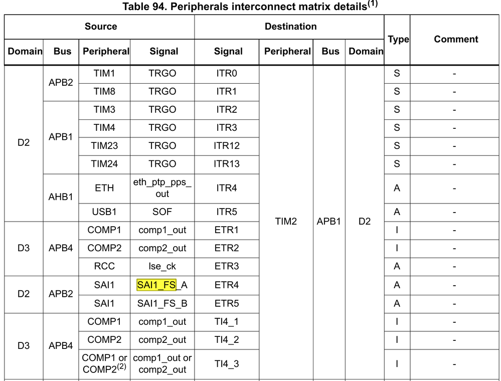

After reviewing the STM32H723ZGT6 reference manual, I found that the USB_SOF signal is an internal interrupt for TIM2 and TIM5. Additionally, SAI1_FS_A, SAI1_FS_B are internally connected as ETR sources for TIM2, and SAI4_FS_A, SAI4_FS_B connected to TIM5.

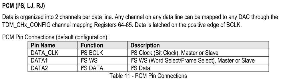

This seems to be a deliberate design by ST to facilitate asynchronous feedback endpoint calculation. If using I2S instead of SAI, such connections typically require an external Timer ETR pin. In PCM mode, this setup works well whether in master or slave mode.

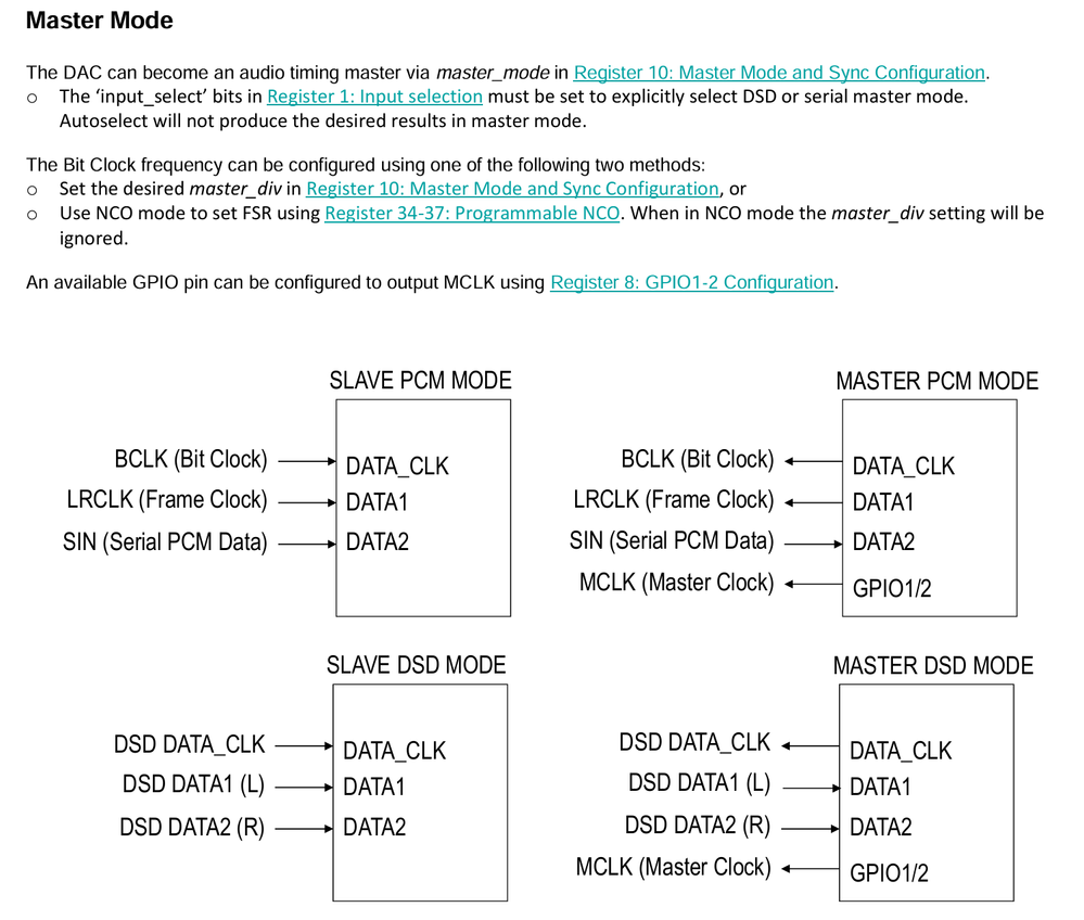

Many DACs, including the ES9039Q2M and AK4493, share pins between DSD and PCM modes. For ESS DACs, the I2S WS pin is shared with DSD channel 1 (Left Channel).
To handle this, I need to switch between these pins. This can be done by directly connecting SAI1_B_SD to SAI1_A_FS (and configuring the GPIO mode) or using a signal switch.

The STM32 manual states that the difference between master and slave modes lies in whether SAI_SCK and SAI_FS are generated by STM32 or come from an external source.
If the DAC is in DSD master mode, there will be no SAI_FS (LRCLK).
so, for STM32, if SAI_FS have no input in asynchronous salve mode, with only DSD DATA_CLK(SAI_SCK) input,  can the STM32 SAI still transmit data correctly?
My idea is to configure STM32 as SAI slave mode. When the DAC switches to DSD mode, I will use a signal switch to disconnect SAI_FS from the DAC and connect it to SAI_SCK (allowing the use of internally connected ETR). However, I am unsure if this is feasible.
