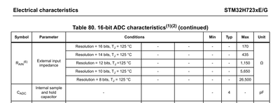

These are listed in the datasheet.

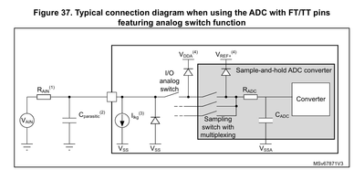

RAIN and CADC form a low-pass filter as described:

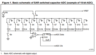

Thanks for sharing that. I was going through AN2834, where a little detailed internal circuit of ADC is shared:
that lead me to query the datasheet specs. So is the CADC equivalent of all these capacitors or just the C. And what about tracking bandwidth?
Capacitance 5 pF total.
Bandwidth is defined by first order LPF:  Fbw = 1/ 2 x PI() x Rin x Cin
