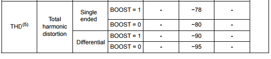

STM32H7 data sheet inconsistancy: Table 85, THD
Uwe Bonnes
Principal III
Posted on March 01, 2018 at 11:09
The second and fourth lower lines in Table 85 both state THD , single ended with BOOST=1, however with different resulting values. Probably the second lowerst line should be THD, Differential, BOOST=1.

Hello
Bonnes.Uwe
You are right, the Table 85 should be as follow for THD state:
I raised this to the appropriate team for correction.
Thanks and Best Regards,
Imen
Thanks
Imen
