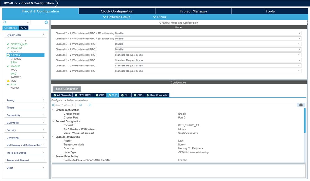

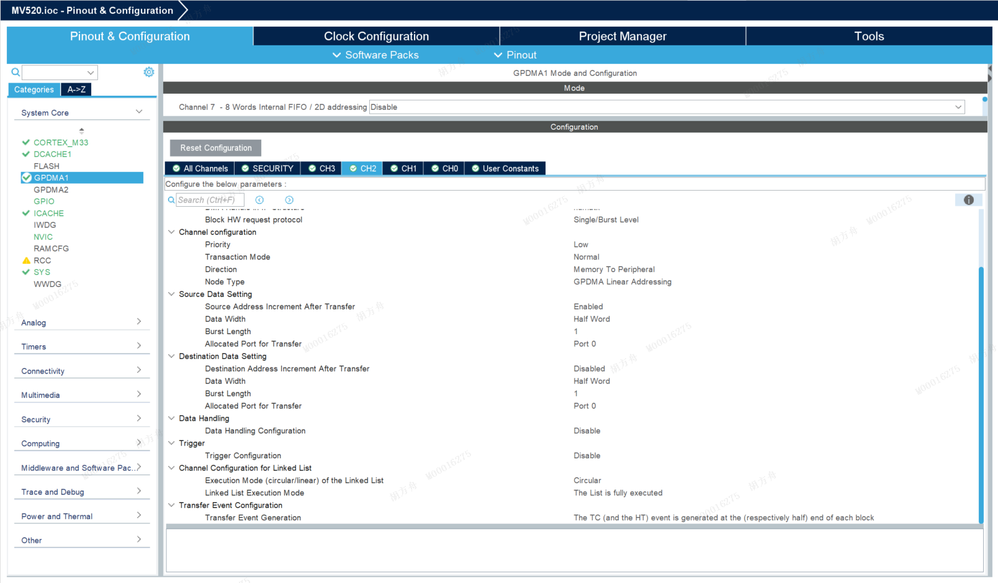

My Configuration of STM32CubeMx as shown in the figure1 and 2.
figure1
figure2

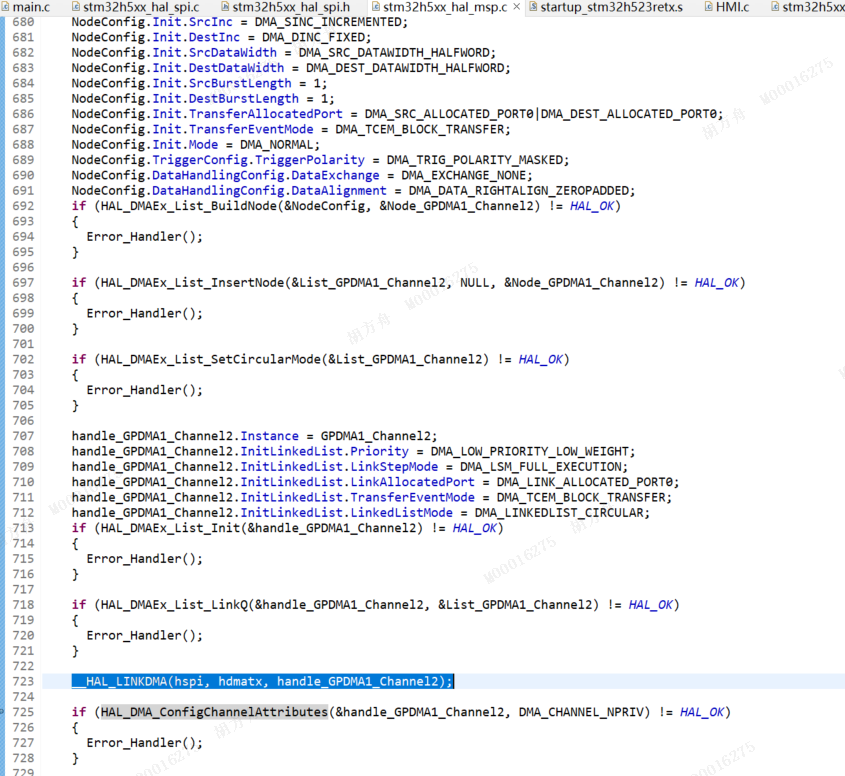

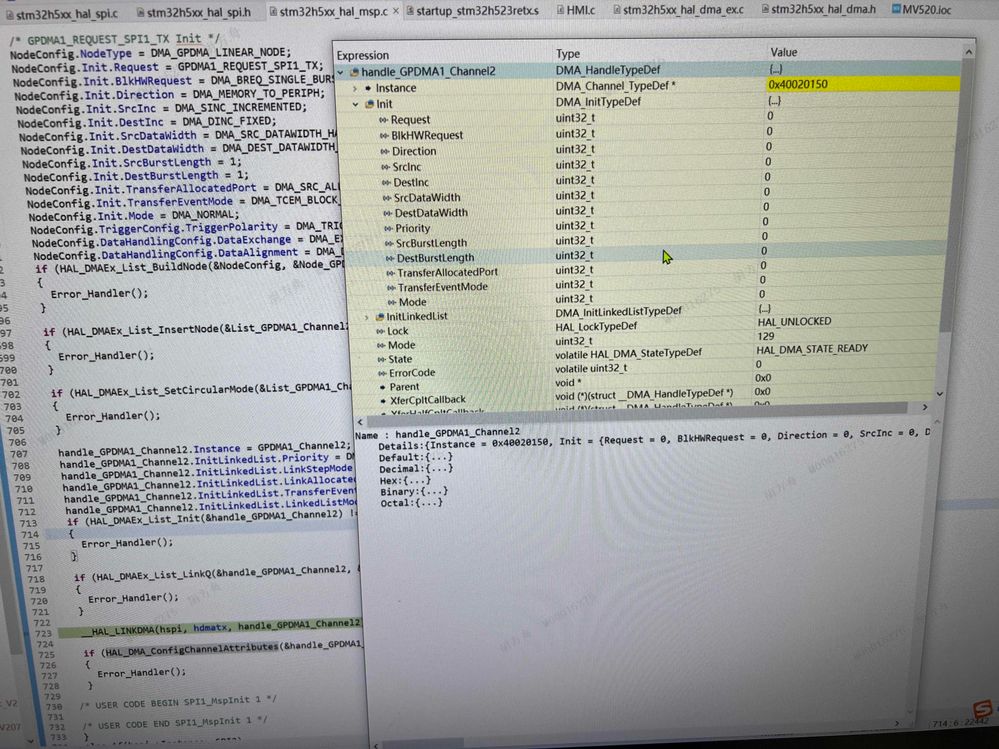

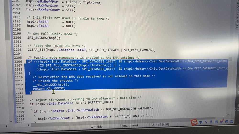

I call the function of HAL_SPI_TransmitReceive_DMA(), it comes to line 2212 of program and return HAL_ERROR then.
I debug the program and find the value of hspi->hdmarx->Init.DestDataWidth is 0, so it return the error.
Then I back to check the initialization of spi1 dma. I find that the Init.DestDataWidth of handle_GPDMA1_Channel2 is already 0 before execute statement __HAL_LINKDMA() .
So I guess maybe somewhere my configuration of spi dma is wrong somewhere and I can't figure it out.

The code you show looks like it's setting the dest width on a linked list node and setting the DMA to circular mode. But your configuration is in standard request mode, and circular mode is disabled. Could you be looking at the wrong place?
If you attach the .ioc file it'd be much easier to follow what you're describing. Since you seem to be using a debugger, showing the stack backtrace would be helpful as well.
Also, try to post screenshots instead of using your phone, or even better post code inside a code block
so it's easier to read.

Here is my code and .ioc file
    /* SPI1 DMA Init */
    /* GPDMA1_REQUEST_SPI1_RX Init */
    NodeConfig.NodeType = DMA_GPDMA_LINEAR_NODE;
    NodeConfig.Init.Request = GPDMA1_REQUEST_SPI1_RX;
    NodeConfig.Init.BlkHWRequest = DMA_BREQ_SINGLE_BURST;
    NodeConfig.Init.Direction = DMA_PERIPH_TO_MEMORY;
    NodeConfig.Init.SrcInc = DMA_SINC_FIXED;
    NodeConfig.Init.DestInc = DMA_DINC_INCREMENTED;
    NodeConfig.Init.SrcDataWidth = DMA_SRC_DATAWIDTH_HALFWORD;
    NodeConfig.Init.DestDataWidth = DMA_DEST_DATAWIDTH_HALFWORD;
    NodeConfig.Init.SrcBurstLength = 1;
    NodeConfig.Init.DestBurstLength = 1;
    NodeConfig.Init.TransferAllocatedPort = DMA_SRC_ALLOCATED_PORT0|DMA_DEST_ALLOCATED_PORT1;
    NodeConfig.Init.TransferEventMode = DMA_TCEM_BLOCK_TRANSFER;
    NodeConfig.Init.Mode = DMA_NORMAL;
    NodeConfig.TriggerConfig.TriggerPolarity = DMA_TRIG_POLARITY_MASKED;
    NodeConfig.DataHandlingConfig.DataExchange = DMA_EXCHANGE_NONE;
    NodeConfig.DataHandlingConfig.DataAlignment = DMA_DATA_RIGHTALIGN_ZEROPADDED;
    if (HAL_DMAEx_List_BuildNode(&NodeConfig, &Node_GPDMA1_Channel3) != HAL_OK)
      Error_Handler();
    if (HAL_DMAEx_List_InsertNode(&List_GPDMA1_Channel3, NULL, &Node_GPDMA1_Channel3) != HAL_OK)
      Error_Handler();
    if (HAL_DMAEx_List_SetCircularMode(&List_GPDMA1_Channel3) != HAL_OK)
      Error_Handler();
    handle_GPDMA1_Channel3.Instance = GPDMA1_Channel3;
    handle_GPDMA1_Channel3.InitLinkedList.Priority = DMA_LOW_PRIORITY_LOW_WEIGHT;
    handle_GPDMA1_Channel3.InitLinkedList.LinkStepMode = DMA_LSM_FULL_EXECUTION;
    handle_GPDMA1_Channel3.InitLinkedList.LinkAllocatedPort = DMA_LINK_ALLOCATED_PORT1;
    handle_GPDMA1_Channel3.InitLinkedList.TransferEventMode = DMA_TCEM_BLOCK_TRANSFER;
    handle_GPDMA1_Channel3.InitLinkedList.LinkedListMode = DMA_LINKEDLIST_CIRCULAR;
    if (HAL_DMAEx_List_Init(&handle_GPDMA1_Channel3) != HAL_OK)
      Error_Handler();
    if (HAL_DMAEx_List_LinkQ(&handle_GPDMA1_Channel3, &List_GPDMA1_Channel3) != HAL_OK)
      Error_Handler();
    __HAL_LINKDMA(hspi, hdmarx, handle_GPDMA1_Channel3);
    if (HAL_DMA_ConfigChannelAttributes(&handle_GPDMA1_Channel3, DMA_CHANNEL_NPRIV) != HAL_OK)
      Error_Handler();
    /* GPDMA1_REQUEST_SPI1_TX Init */
    NodeConfig.Init.Request = GPDMA1_REQUEST_SPI1_TX;
    NodeConfig.Init.Direction = DMA_MEMORY_TO_PERIPH;
    NodeConfig.Init.SrcInc = DMA_SINC_INCREMENTED;
    NodeConfig.Init.DestInc = DMA_DINC_FIXED;
    if (HAL_DMAEx_List_BuildNode(&NodeConfig, &Node_GPDMA1_Channel2) != HAL_OK)
      Error_Handler();
    if (HAL_DMAEx_List_InsertNode(&List_GPDMA1_Channel2, NULL, &Node_GPDMA1_Channel2) != HAL_OK)
      Error_Handler();
    if (HAL_DMAEx_List_SetCircularMode(&List_GPDMA1_Channel2) != HAL_OK)
      Error_Handler();
    handle_GPDMA1_Channel2.Instance = GPDMA1_Channel2;
    handle_GPDMA1_Channel2.InitLinkedList.Priority = DMA_LOW_PRIORITY_LOW_WEIGHT;
    handle_GPDMA1_Channel2.InitLinkedList.LinkStepMode = DMA_LSM_FULL_EXECUTION;
    handle_GPDMA1_Channel2.InitLinkedList.LinkAllocatedPort = DMA_LINK_ALLOCATED_PORT0;
    handle_GPDMA1_Channel2.InitLinkedList.TransferEventMode = DMA_TCEM_BLOCK_TRANSFER;
    handle_GPDMA1_Channel2.InitLinkedList.LinkedListMode = DMA_LINKEDLIST_CIRCULAR;
    if (HAL_DMAEx_List_Init(&handle_GPDMA1_Channel2) != HAL_OK)
      Error_Handler();
    if (HAL_DMAEx_List_LinkQ(&handle_GPDMA1_Channel2, &List_GPDMA1_Channel2) != HAL_OK)
      Error_Handler();
    __HAL_LINKDMA(hspi, hdmatx, handle_GPDMA1_Channel2);
    if (HAL_DMA_ConfigChannelAttributes(&handle_GPDMA1_Channel2, DMA_CHANNEL_NPRIV) != HAL_OK)
      Error_Handler();

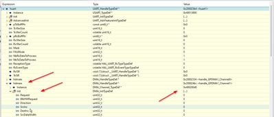

JohVis71
I have exactly the same problem with STM32H573 when using SPI with DMA in circular mode.
once in Circular mode, it says in CubeMX, that is is using it in linked list mode in the background. Then the HDMA init section is NULL
This seems to be valid for ALL hardware configured with DMA in circular mode. In this example I have setup a UART RX in DMA reception circular mode,
huart.hdmarx.init is NULL despite the fact, that DMA is initialized and running.
For UARTs this is less of a problem
For SPI, there is a test in the DMA transmitReceive section, which checks if the data sizes and the amount of bits beeing transmitted, match.
8 bits or less -> byte transfer
more than 8 bits -> half-word transfer:
For that it looks into the init struct and finds it not initialized. -> error.
JohVis71
I have a temporary solution
