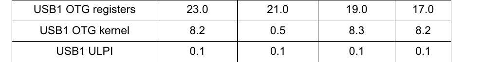

from ds , USB current /MHz :
-> so at 200M could be around 0.6 mA .

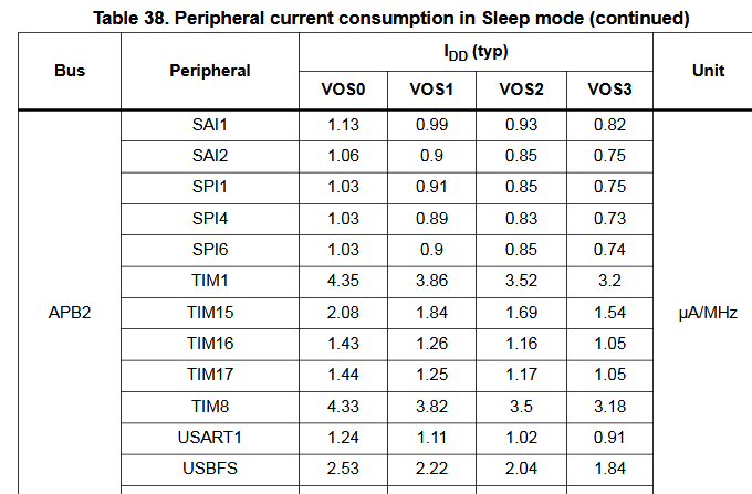

In our case, we wanted to use Vdd = 1.8V. In this case, VDDUSB should be 3.3V. Is this correct?
In this case, is the current in Table 38 drawn from Vdd (1.8V) or from Vddusb?
As stated in title and context, current consumption in sleep mode.
About  I_DD(USBBCD) ≈ 300 µA for the USB Battery Charging Detection. So, it is just one component of the total USB domain current.

So just lets look at H743 ds, where (average ! , not peak) current is given:
in uA/MHz run mode; so at 200MHz about (30*200) 6000uA, 6mA . (all at 3v3 VDD , at 25°)

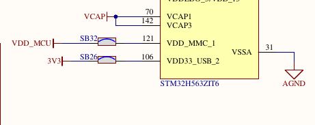

At high temp the current is higher...so if you want to know exactly : use a H563 nucleo board, set core VDD_MCU to 1v8 and measure with the mode you want to use the usb the current on the SB26 , which is there to do this. :)
Then you know it for real.
Just to decide, how to supply it : take any small LDO 3v3 , they all can deliver > 100mA , so no problem here.
It doesn't matter whether the USB requires 0.5 or 50mA peak current, you are on the safe side.
