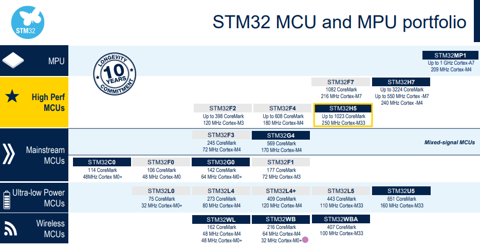

The new STM32H5 series comes to complete the STM32 High Performance MCUs portfolio.
It comes to complete the F4 series.
For more details, you can check the Product Presentation : STM32H5 MCU series Most powerful Arm® Cortex®-M33 MCU yet

Thank you Foued. But my question is, why H5 clock rate is lower than H7. Is it a limitation of CM33 core vs. CM7, or has other reasons?

The STM32H5 comes to complete the STM32F4 not STM32H7 , STM32G4...
So , If you have a look on the portfolio you can find the STM32H5 after the STM32F4.
