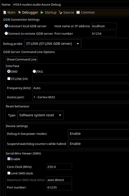

SWO is not different , its connection to debug unit; if you set everything in "working condition", it will work.
see my debug setting:

In IDE i showed , what to set in debug setup. (For jlink tools - i dont know. You should ask this at Segger..)
