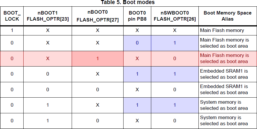

My hardware design doesn't connect the BOOT0-Pin to a specific voltage level. That's why I need to write to the OPTR Register so that the BOOT0-Pin is not read at the boot sequence.
I check the OPTR Register:
FLASH->OPTR = ffeff8aa
  RDP         = aa
  BOR_LEV     = 0
  nRST_STOP   = 1
  nRST_STDBY  = 1
  nRST_SHDW   = 1
  IWDG_SW     = 1
  IWDG_STOP   = 1
  IWDG_STDBY  = 1
  WWDG_SW     = 1
  BFB2        = 0
  DBANK       = 1
  nBOOT1      = 1
  SRAM_PE     = 1
  CCMSRAM_RST = 1
  nSWBOOT0    = 1
  nBOOT0      = 1
  NRST_MODE   = 3
  IRHEN       = 1
I need to clear the nSWBOOT0 so that the BOOT0-pin is not been evaluated anymore.

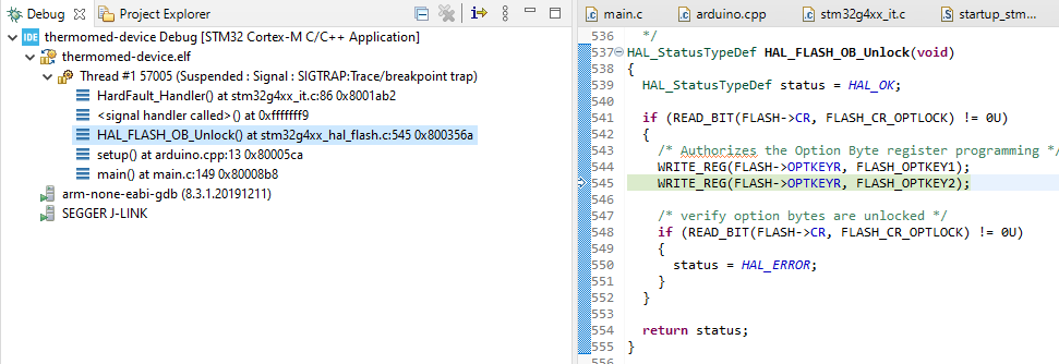

... but it goes to the HardFault_Handler:
0693W00000FBoVkQAL.pngMy question: why?
ABach.4
I found something related here: Unlock readout protection
It first unlocks the Flash itself with HAL_FLASH_Unlock()
Now it works!
