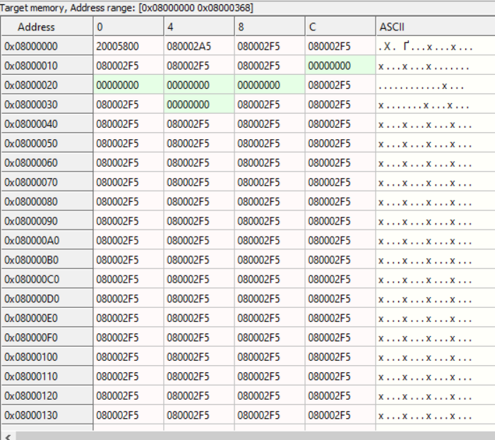

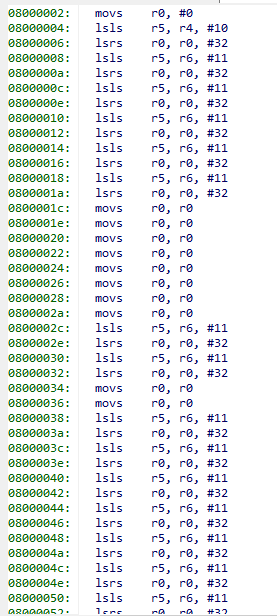

0693W000000WTqUQAW.png0693W000000WTpIQAW.pngDisassembly shows some weird stuff in the beginning.
Yeah, that would be the vector table, a list of addresses, and not executable code you can disassemble.
Odd the FLASH basis isn't 0x08000000, but not my part.
Make sure your design pulls BOOT0 low.​
