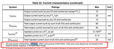

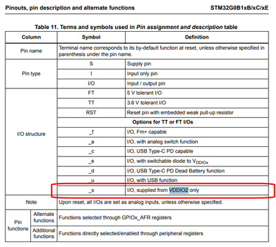

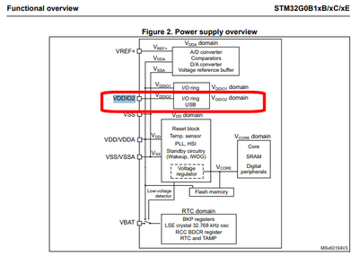

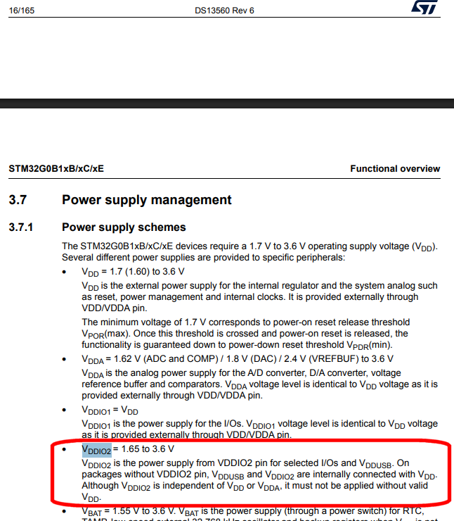

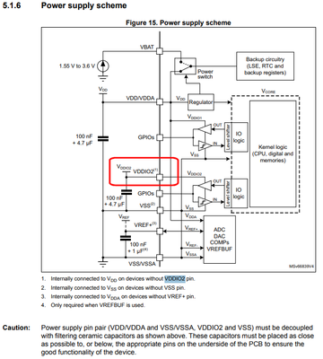

Hello I'm trying to wire up the STM32G0B1CET6N and I don't know how to use the VDDIO2 pin. What is it for and how should I wire it?

For the STM32G0B1CET6N, the VDDIO2 supply powers GPIO PG[15:2]. In a normal design, you can tie VDDIO2 to VDD and add a local decoupling capacitor.
Andrew Neil
Did you check the datasheet?
Hint: it's a PDF document, so you can use the 'Search' facility to find all occurrences of "VDDIO2":
https://www.st.com/resource/en/datasheet/stm32g0b1ce.pdf#page=17
See also Application Notes AN5096Getting started with STM32G0 MCUs hardware development
