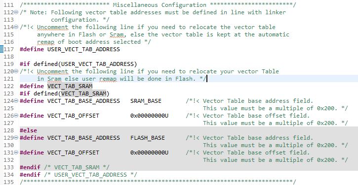

stm32cube mx just generate flash.ld linker script. So I create my own ram.ld linker script, also i modify system_stm32g0xx.c to point the entry point to sram
/* Note: Following vector table addresses must be defined in line with linker
         configuration. */
/*!< Uncomment the following line if you need to relocate the vector table
     anywhere in Flash or Sram, else the vector table is kept at the automatic
     remap of boot address selected */
#define USER_VECT_TAB_ADDRESS
#if defined(USER_VECT_TAB_ADDRESS)
/*!< Uncomment the following line if you need to relocate your vector Table
     in Sram else user remap will be done in Flash. */
#define VECT_TAB_SRAM
#if defined(VECT_TAB_SRAM)
#define VECT_TAB_BASE_ADDRESS   SRAM_BASE       /*!< Vector Table base address field.
                                                     This value must be a multiple of 0x200. */
#define VECT_TAB_OFFSET         0x00000000U     /*!< Vector Table base offset field.
#else
#define VECT_TAB_BASE_ADDRESS   FLASH_BASE      /*!< Vector Table base address field.
#endif /* VECT_TAB_SRAM */
#endif /* USER_VECT_TAB_ADDRESS */

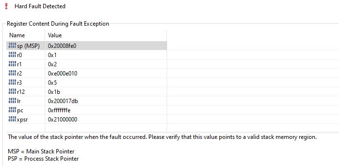

However, in debug operation, mcu get hard fault interrupt.
This is the summary.
JCuna.1
Senior
Issue solved. I was not using the linker script at the compilation/linking configuration. The code runs perfectly when debugging without modify de boot option byte.​
