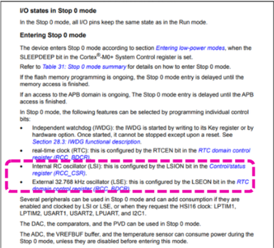

Hello @levantg
I don't think it's a problem about make file configuration
I noticed that you are using LSI as clock source while the provided project using HSI
with HSI I did not find any problems.
the reference manual stated that when using LSI to enter stop mode you should enable the clock individually by using this line of code
 /* USER CODE BEGIN 2 */
  __HAL_RCC_LSI_ENABLE();
  /* USER CODE END 2 */
using LSI or LSE without that line of code will not make the stm32 able to enter stop mode
you can try this code sequence
  /* Infinite loop */
  /* USER CODE BEGIN WHILE */
  while (1)
    /* USER CODE END WHILE */
    /* USER CODE BEGIN 3 */
	  HAL_Delay(2000);
	  	  HAL_PWR_EnterSTOPMode(PWR_LOWPOWERREGULATOR_ON, PWR_STOPENTRY_WFI);
  /* USER CODE END 3 */
 if it did not solve your issue return to us with feedback
Hope that solved your problem, if yes please accept it as solution to make it visible for other users
Gyessine
Gyessine
hello @levantg
After further investigation, the problem appears to be related to the SysTick itself, and not to the low-power mode.
Using LSI results in a low value in the STK_RVR register (0x1F), which causes the microcontroller to get stuck in the SysTick handler and prevents it from performing other tasks.
The solution is to reduce the SysTick frequency from 1 kHz to 100 Hz by adding the following code in place of the existing code in stm32g0xx_hal.c:
//HAL_TickFreqTypeDef uwTickFreq = HAL_TICK_FREQ_DEFAULT;  /* 1KHz */
HAL_TickFreqTypeDef uwTickFreq =   HAL_TICK_FREQ_100HZ;
//instead of
or just pick another timebase instead of systick like TIM1 using cubeMX
here I attached a project that can help you just add low power functionalities to it
Hope that helps you solve your issue
Gyessine
