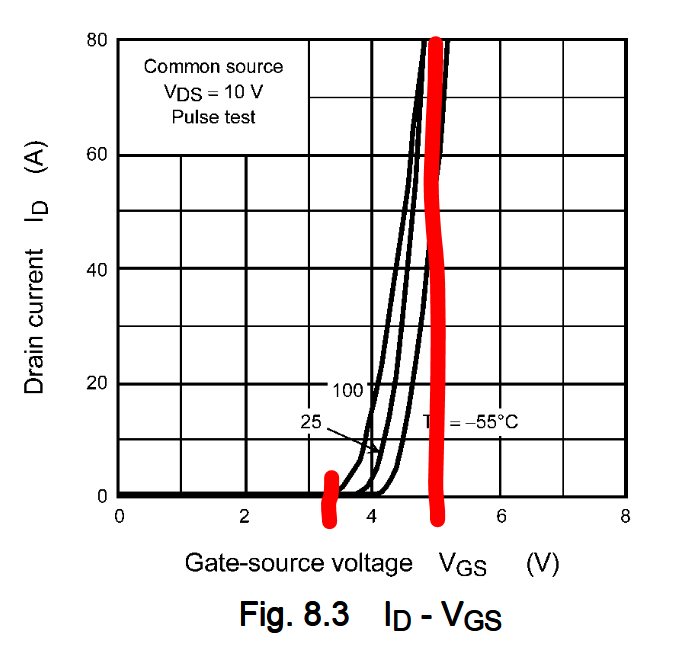

There's a big difference in how that FET behaves when VGS is 3.3V and when it's 5V. Driving the pin to 3.3V just doesn't turn it on fully.
Threshold is listed as 2V min, 4V max.

The mcu runs off of 3.3V. The pins will output 3.3V when high.
The 5V input gets fed into a voltage regulator which supplies the mcu.
It has pins which are 5V tolerant, but frequently the DISCO/NUCLEO's run the MCU at 3.0V or 3.3V, and you certainly can't be attaching 5 VDC to the VDD pins of the MCU
You could configure the GPIO in OD (Open Drain), and pull the pin to 5V for the high side voltage of pins marked "FT" in the data sheet.
