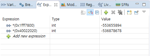

Hi, I tried to debug with ST Link and found something strange. First, FLASH_SECR register not exist. I think stm32g0x0 series don't have it. And another strange point is this.
After I executed code that changing option byte, option bytes in the information block (address 0x1FFF7800) was 0xDEFFE1AA (nBOOT_SEL = 0), but FLASH_OPTR (address 0x40022020) was 0xDFFFE1AA (nBOOT_SEL = 1). Is it correct that the option bytes changes have been applied properly?
