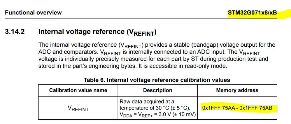

I wonder where I can find VREFINT_CAL_ADDR ,Thanks�?

For what chip?

It's in the HAL LL library as well. Apparently the same for all STM32G0 chips:

Thanks!
