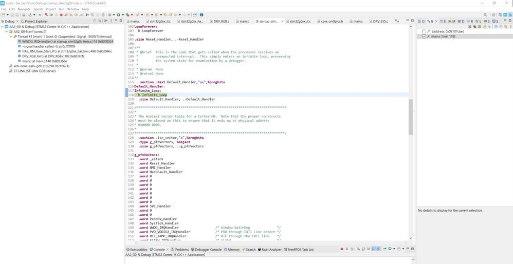

Enabling any interrupt at the initialization triggers the WWDG_IRQHandler when watchdog timer doesn't even configured in the code whereas excluding bootloader fw doesn't seem to cause any issues, code runs fine. In the bootloader fw, I haven't configured any interrupts except the cubemx generated system interrupts such as NMI, Hardfault, svc, Pendsv, systick and RCC_CRS.
I've ensured to define handler for all interrupt request in the app fw. code is developed for stm32g0b1ret6 mcu
Here is my jump to app code look alike:

‎2023-02-27 12:57 AM
It's a catch-all Handler, dozens of the vectors point here.
Determine which is firing, perhaps USART or SysTick. Narrow down to what loader uses. Ensure VTOR is aligned​
‎2023-02-26 11:28 PM
Looks like it's debugged already - see the called procedures' hierarchy in the left pane - watchdog interrupt is firing.
‎2023-02-26 11:39 PM
watchdog hasn't been configured in the code. It is the default handler who is triggering the watchdog handler. Not sure why?
‎2023-02-27 12:56 AM
Issue has been sorted. It was because of improper address in the VTOR register in app fw.
