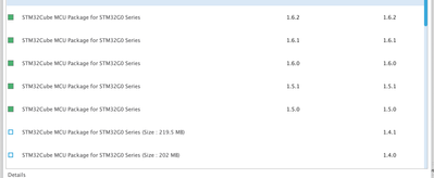

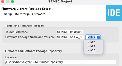

STM32G0 1.5.0 package version
grisom13
I am fighting about a week to enable USB-PD comms on my STM32G0B1 MCU and even chat GPT literally told me - he don't have a solution ( shock, a?) One last try before I quit, is to try 1.5.0 package version but I can see in cube MX  only 1.6.0 the earliest. (attached). Repository has 1.5.0 folder and zip. Any ideas?

Hello @grisom13
To be able to use the STM32CubeIDE and the STM32CubeMX together with the STM32CubeG0 V1.5.0, you have to use an older version of the STM32CubeMX and STM32CubeIDE (tools versions released before the STM32CubeG0 V1.6.0).
Best Regards.
II
I have installed IDE 1.10.1 And can see same options (1.6.0 ealiest)
Any ideas what version could be best ?
Hello @grisom13
You may try using the STM32CubeIDE V1.8.0 or the V1.7.0 together with the STM32CubeMX V6.5.0 or the V6.4.0.
Best Regards.
Ii

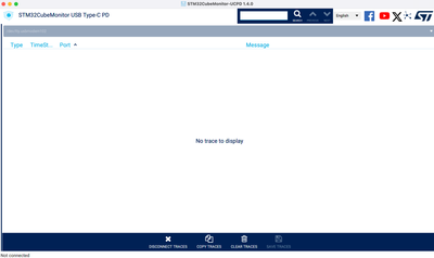

grisom13
I am trying to use STM32Cube Monitor USB PD with custom board.
I see ST link v3 minie on a trace port. but I can't see any traces at all. Is there a dedicated package in CubeMX i can enable to see USB-PD traces ? Thank you.
Hello @grisom13
This is a different question. If your original question  is answered. Please select the comment that answer your original question as best answer and open a new topic on the Cube monitor forum to give it more visibility.
Best Regards.
II
